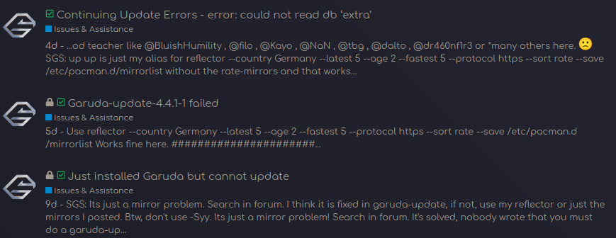

The forum is full of this warnings
pacman -Qi garuda-update
Version                  : 4.5.1-1
fixed it.
So, if missing that one, do
sudo pacman -S garuda-update
otherwise, search for reflector (mirror)s in the forum.
Okay, I did the search and found the answer for skipping the mirrorlist test. I’ll just run this, that’ll adequately solve that nag for me.
garuda-update --skip-mirrorlist
Thanks again for the help.
Edit the config file, no need for
--skip-mirrorlist
