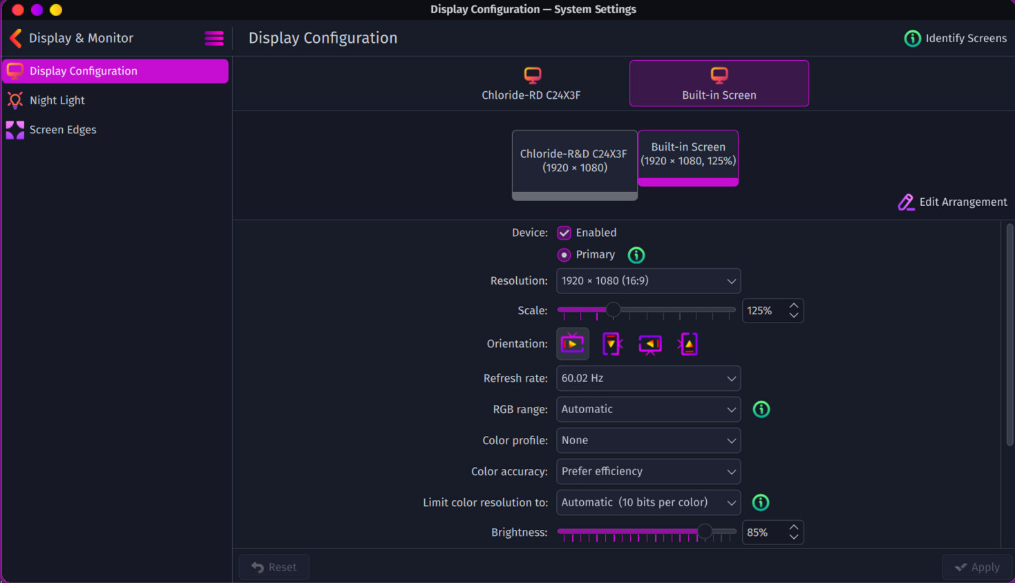

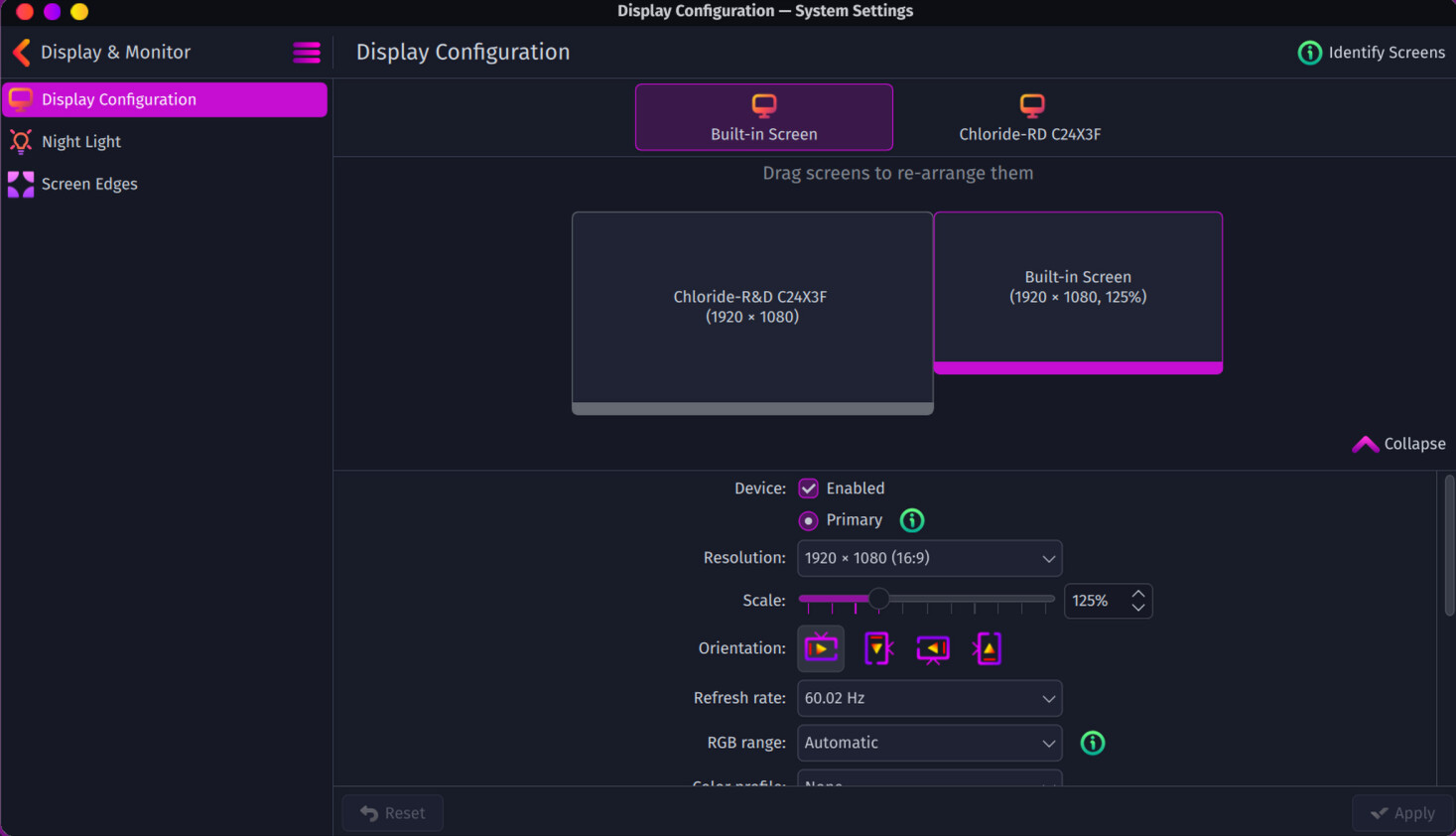

normally you can set it up in the settings may you do a screenshot and post it here to guide you;) (This is what @nepti mean to show us the settings if there not a secret :wink: )
This is my configuration. garuda-inxi shows HDMI as primary and that is rare.

It is a bug?
Thats depending on the Lapop or PC . Seems like wrong or bug but try it with the other screen to set as primary . Or disconnect it and reboot then connect it again :wink:

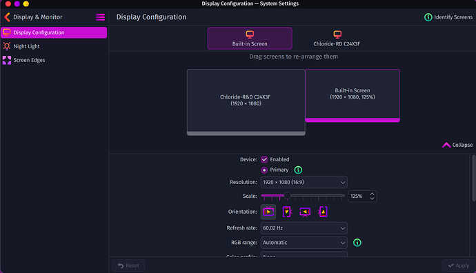

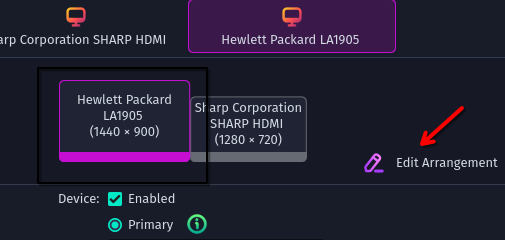

you can edit here the arrangement too and apply to safe it. (click the inbuild one and move it to the left side)
Useless. Set notebook primary and HDMI left, reboot, but garuda-inxi shows the opposite.
is there no changes if you play arround with this settings? It worked on my Pc without issues.
it is not where the Monitor has is place [quote=“pergamin, post:7, topic:46673”]
HDMI left
[/quote]
Put the Inbuild Monitor on LEFT side :wink:

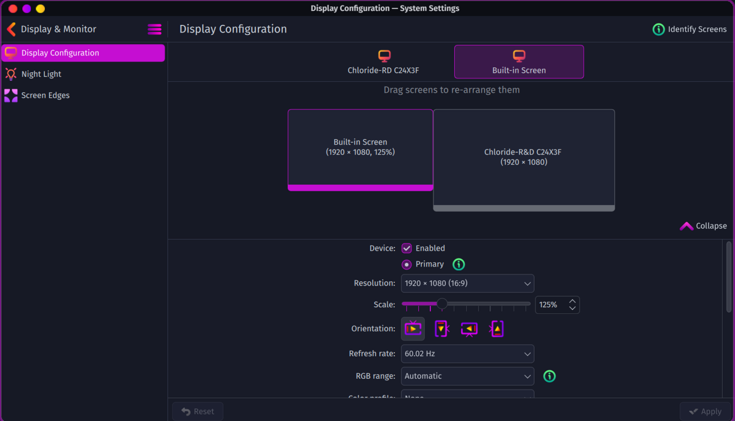

Done, it seems that wotks:
Monitor-1: HDMI-A-1 pos: right model: C24X3F built: 2024 res:
mode: 1920x1080 hz: 100 scale: 100% (1) dpi: 93 gamma: 1.2
max: 1920x1080 min: 640x480
Monitor-2: eDP-1 pos: primary,left model: LG Display 0x0540 built: 2017
res: mode: 1920x1080 hz: 60 scale: 125% (1.25) to: 1536x864 dpi: 142
gamma: 1.2 size: 344x194mm (13.54x7.64") diag: 395mm (15.5") ratio: 16:9
modes: 1920x1080
But, the problem is that my desk setup need HDMI as secondary left. That’s my physical desk dispose.
And, when I put the buildin monitor on the left, All configuration lost and HDMI acts as primary left.

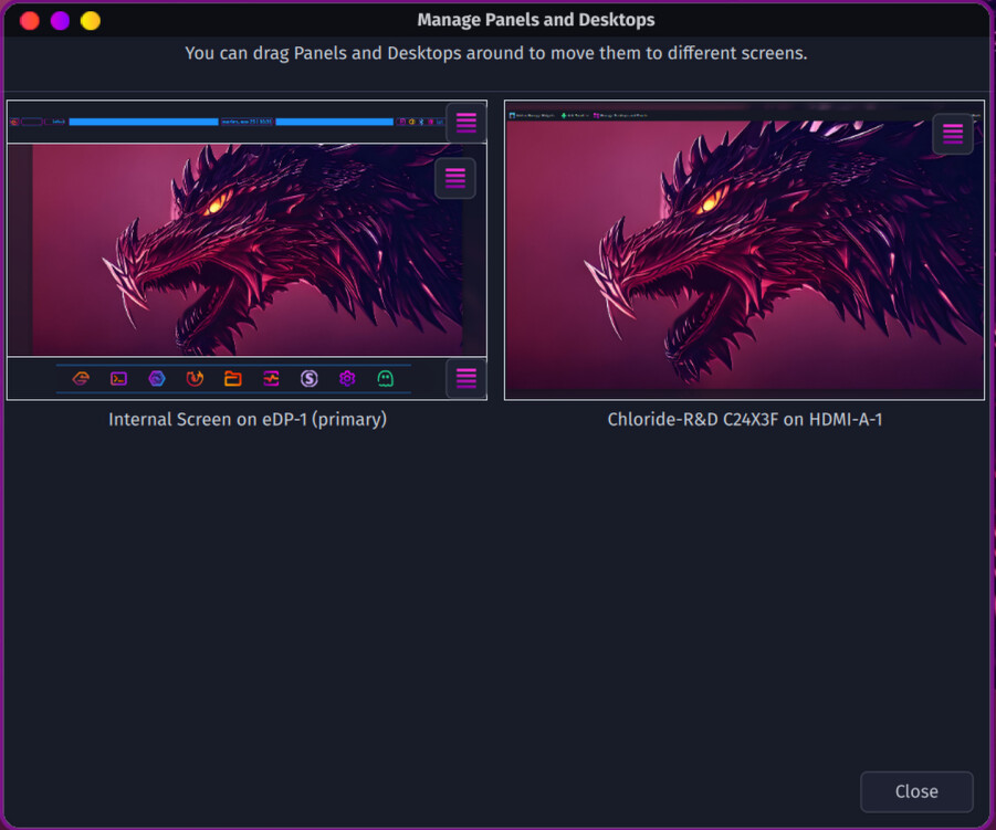

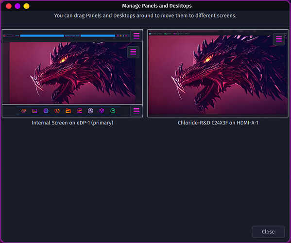

Right-click on the Desktop and choose Enter Edit Mode. Choose Manage Panels and Desktops at the top. In the Manage Panels and Desktops window, click on the button with the 3 horizontal lines to the right of the taskbar panel, and choose the option to move it to your other Monitor.Maybe this can work for you.

Done, but, it hide or erase all icons instead of sending from HDMI to Builtin.
Rebooting…
In rebooting… all icons were gone all again to the HDMI, not the Builtin.
Obviously is a bug.
