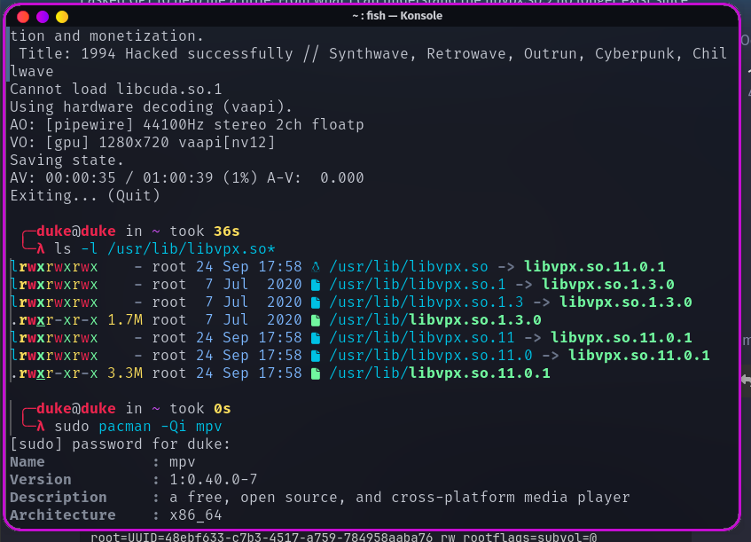

mpv: error while loading shared libraries: libvpx.so.9: cannot open shared object file: No such file or directory
I asked GPT to help me a little. From what I can understand the libvpx.so.9 no longer exist since i have a newer version but some packages are still looking for it for some reasons.
╭─heckza@garuda in ~ as 🧙 took 45s
╰─λ ls -l /usr/lib/libvpx.so*
lrwxrwxrwx    - root 24 Sep 12:58  /usr/lib/libvpx.so -> libvpx.so.11.0.1
lrwxrwxrwx    - root  7 Jul  2020  /usr/lib/libvpx.so.1 -> libvpx.so.1.3.0
lrwxrwxrwx    - root  7 Jul  2020  /usr/lib/libvpx.so.1.3 -> libvpx.so.1.3.0
.rwxr-xr-x 1.7M root  7 Jul  2020  /usr/lib/libvpx.so.1.3.0
lrwxrwxrwx    - root 24 Sep 12:58  /usr/lib/libvpx.so.11 -> libvpx.so.11.0.1
lrwxrwxrwx    - root 24 Sep 12:58  /usr/lib/libvpx.so.11.0 -> libvpx.so.11.0.1
.rwxr-xr-x 3.3M root 24 Sep 12:58  /usr/lib/libvpx.so.11.0.1
I’m afraid of breaking stuff, but I tried, reinstalling packages, ( -Rns ). I tried different suggestion from GPT, but they were mostly for the mpv problem before I saw that Spectacle was also having the same issue, which might suggest I have more packages with the exact same problem.
Apart from Updating (garuda-update / flatpak update & yay -Syu), I did not retry anything just in case it might brake something.

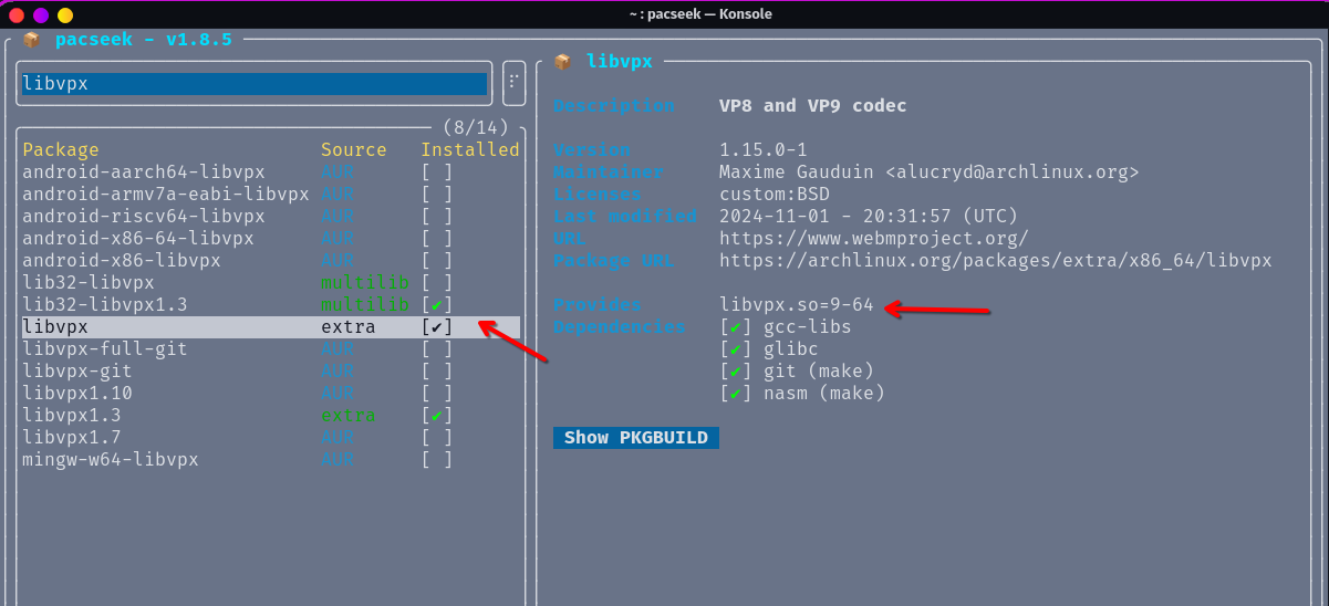

Can you check if you have this package installed ?
paru -S libvpx
ps. now i see the error too didnt updated today my fault.

I already gave this information in the opening post. version 9 is nowhere to be found since it was updated to the latest version.
the garuda-update never update my AUR packages!
because I do yay -Syu right after my reboot, and all my packages are out of date every time and it takes around 1H to update the few AUR packages I have to update. lol
The problem is not libvpx. The issue is mpv and spectacle. You have the latest version, but your latest version is not like the latest version everyone else has… Your spectacle and mpv are not the same. Our mpv and spectacle needs libvpx 11, yours needs version 9. I don’t know how this is happening.
if it can help, when I was trying GPT stuff a little, I pasted an output and It started to talk about Snapshots
What I pasted :
🔍] × which mpv
/usr/bin/mpv
╰─λ pacman -Qo $(which mpv)
/usr/bin/mpv is owned by mpv 1:0.40.0-7
╰─λ ldd $(which mpv) | grep vpx
libvpx.so.9 => not found
╰─λ sudo find / -type f -name mpv -executable 2>/dev/null
/usr/bin/mpv
/.snapshots/773/snapshot/usr/bin/mpv
/.snapshots/774/snapshot/usr/bin/mpv
/.snapshots/775/snapshot/usr/bin/mpv
/.snapshots/778/snapshot/usr/bin/mpv
/.snapshots/779/snapshot/usr/bin/mpv
/.snapshots/780/snapshot/usr/bin/mpv
/.snapshots/781/snapshot/usr/bin/mpv
/.snapshots/782/snapshot/usr/bin/mpv

[🔴] × mpv --version

can you try to restore a snapshot before you got this issues?
otherwise you can try to downgrade libvpx back to the erlierer 1.15.0-1 version. This is not helping on your spectacle problem.
