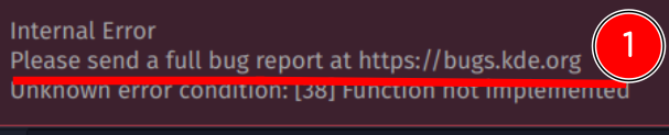

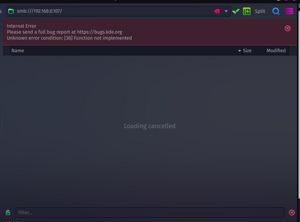

I’ve installed the new Bird of Pray Plasma 6 release and while I managed to get 99% working, can’t seem to mount/add/browse my NAS(Synology drive).
I am getting some weird bug report error:

Thank you, thought that I am missing something as I actually enter my login and password at the destination and then getting the error.

Try the address as smb://hostname.local (even if your lan dhcp suffix is different, the .local is from zeroconf or multicast or w/e it’s called - I’m hazy on the details)
I had same issue with one of my truenas-es and it would only work via the .local suffix, .lan was throwing error as was ip (though, after rebooting both the garuda machine and the offending nas all 3 methods work).
Pfu sorted! What it was that my nas was accepting only smb2. Just change that value to smb3 and everything immediately started working!
Thank you @SGS for making me search for the issue, I didn’t really as I though searching for not implemented function is a long shot :slight_smile:
