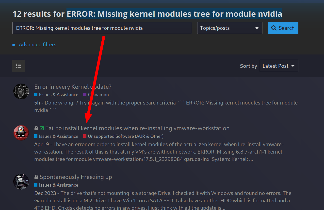

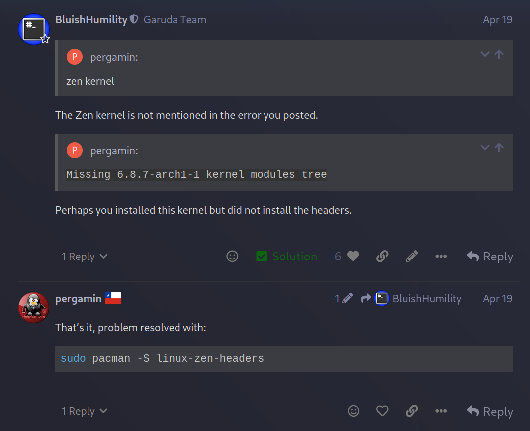

Since every update, system always send this to console:
( 7/18) Install DKMS modules
==> dkms install --no-depmod broadcom-wl/6.30.223.271 -k 6.10.1-zen1-1-zen
==> dkms install --no-depmod nvidia/470.256.02 -k 6.10.1-zen1-1-zen
==> dkms install --no-depmod vmware-workstation/17.5.2_23775571 -k 6.10.1-zen1-1-zen
==> depmod 6.10.1-zen1-1-zen
==> ERROR: Missing 6.10.1-arch1-1 kernel modules tree for module nvidia/470.256.02.
==> ERROR: Missing 6.10.1-arch1-1 kernel modules tree for module broadcom-wl/6.30.223.271.
==> ERROR: Missing 6.10.1-arch1-1 kernel modules tree for module vmware-workstation/17.5.2_23775571.
And the system continues with correct updating.
