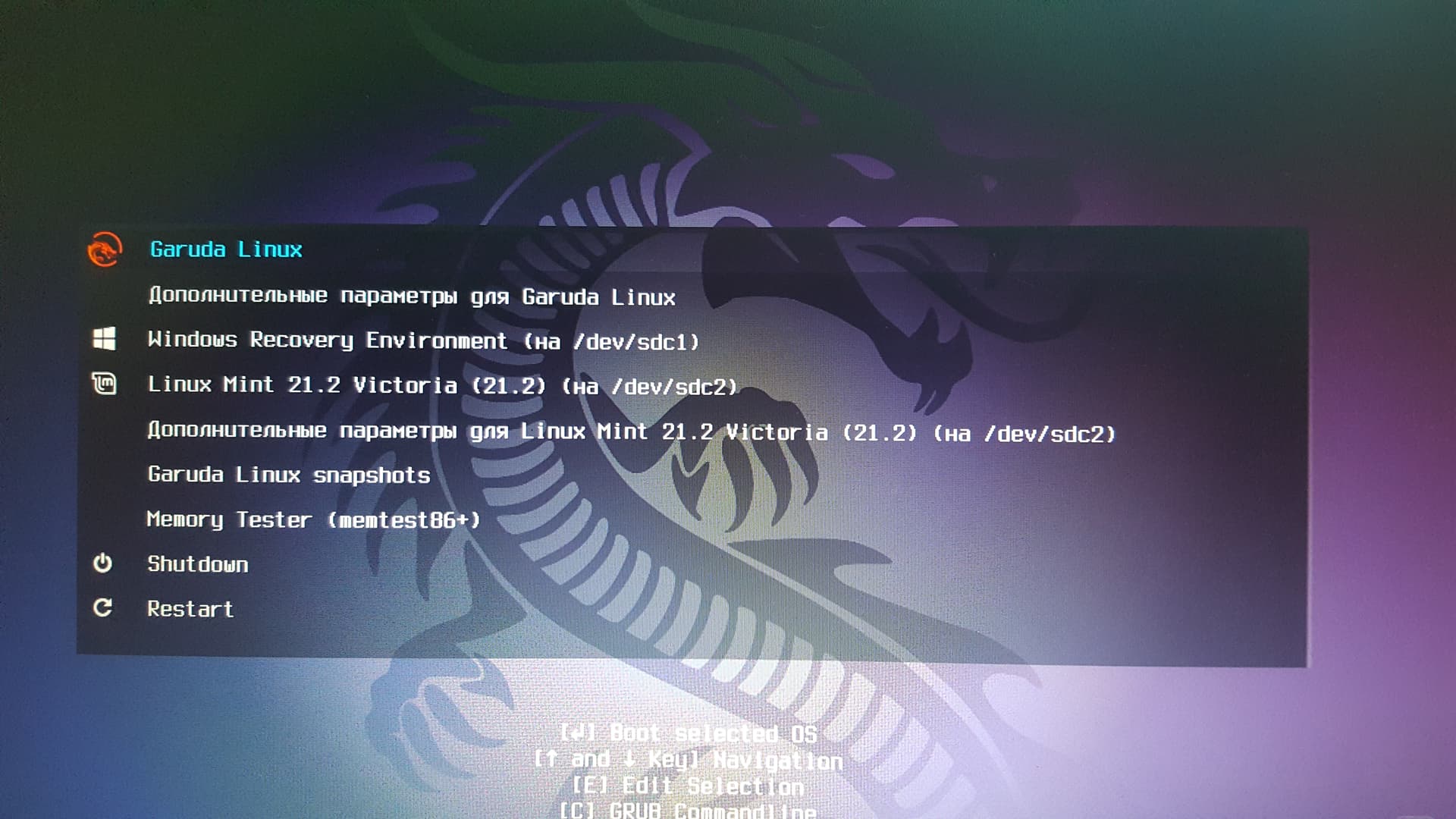

Greetings! I have been using double and triple loading of the System on my computer for about 10 years. This is very good for all occasions. The main disadvantage of double or triple booting or more is restoring Grub after reinstalling Windows or Linux. Even when you install another Linux distribution, for some reason its bootloader does not see the already installed Garuda distribution and, accordingly, does not show it in the boot menu! Therefore, it is necessary to restore the Garuda bootloader with its beautiful screen for selecting a particular System.
Now I use three Systems on my laptop - Garuda Linux, Linux Mint and Windows. But if you can restore the Linux Mint bootloader quite simply and quickly by entering the appropriate commands in the terminal after booting from the installation flash drive of the desired version of Linux. I just couldnât manage to restore the Garuda boot after installing a different version of the operating system on another logical drive! Iâll describe how I solved this problem in a simple way, which Iâm very happy about!

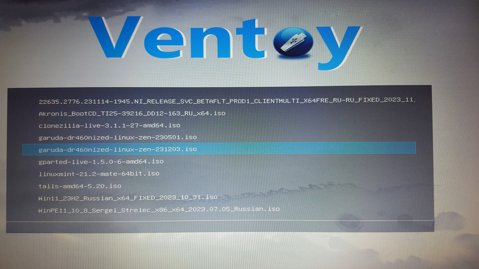

Initially, I split the new ssd disk using the gparted-live-1.5.0-6-amd64.iso boot disk into three equal 60 Gb partitions. Next I installed Windows 11, Linux Mint Mate and Garuda Linux. Accordingly, Grub from Garuda was installed as the last option, and when you restart the computer, you now select the System you need to work with. Now the most important thingâŚHaving fully configured Garuda for ourselves with the installation of the necessary software, we use the boot disk clonezilla-live-3.1.1-27-amd64.iso to make a complete backup copy of Garuda and save it on another logical drive. This backup copy takes up 7.9 Gb for me, which is not so much. But now, when reinstalling a new version of Windows or Linux Mint, you donât need to reinstall Garuda again!
Simply by booting from the clonezilla-live-3.1.1-27-amd64.iso bootable flash drive, I restore Garuda from the backup copy to the desired disk and within 5-7 minutes you have a working Garuda System in its newly installed and configured form! Yes, to create a multiboot flash drive I use the Ventoy program where I have all my System images for work and installation. This may be a somewhat archaic recovery method, but it is fast and actually works. All the best!
