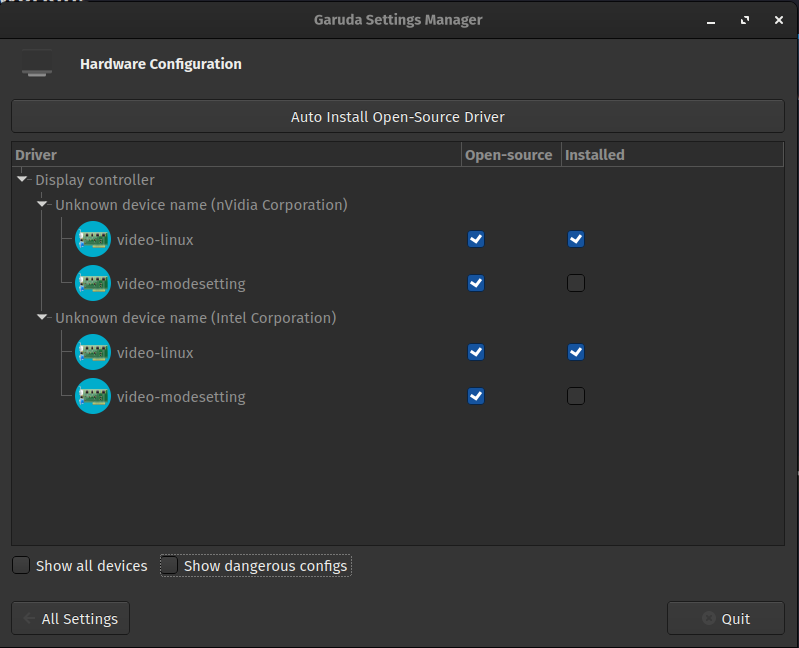

I'm using an RTX 4070 (Razer Blade 16 2023) and I've tried installing the nvidia-dkms, nvidia-beta-dkms, nvidia-535xx-dkms, etc. I've also tried switching my kernel from linux-zen to linux, and linux-lts (installed headers for these as well), and then installed the nvidia drivers and nvidia-lts drivers, and tried variations of those drivers when the basic ones didn't work. I did a roll back to a clean snapshot before trying a different kernel or a different version of a driver. This is a brand new, fresh install of Garuda KDE (dragonized). I tried the gnome version as well, which uses wayland.
One thing I noticed, in the hardware settings that should list the drivers, no nvidia drivers ever show up. In fact, the GPU says unknown device (NVIDIA corporation).
I gave up this morning, after exhausting the forums and arch wikis and installed Ubuntu Desktop. Video is detected and seems to be working out of the box. Sound on the Blade 16 still seems to be broken, but at least the GPU is detected and drivers install. I can use a headset or bluetooth until the builtin speakers are fixed. For the record, the generic nvidia-535 drivers are installed and seem to be working on Ubuntu. I'm not sure why similar versioned drivers on Arch/Garuda don't seem to work.

  pm: pacman pkgs: 1102 libs: 342 tools: pamac,paru Shell: fish v: 3.6.1
  default: Bash v: 5.1.16 running-in: gnome-terminal inxi: 3.3.28
  System install date:     2023-08-08
  Last full system update: 2023-08-08
  Failed units:            systemd-backlight@backlight:nvidia_0.service
Preparing...
Resolving dependencies...
Checking inter-conflicts...
Warning: dependency cycle detected:
Warning: eglexternalplatform will be installed before its nvidia-utils dependency
Checking keyring...
Checking integrity...
Loading packages files...
Checking file conflicts...
Checking available disk space...
Running pre-transaction hooks...
Performing snapper pre snapshots for the following configurations...
==> root: 9
Installing dkms (3.0.11-1)...
Installing eglexternalplatform (1.1-2)...
Installing egl-wayland (2:1.1.12-1)...
Installing nvidia-utils (535.86.05-2)...
If you run into trouble with CUDA not being available, run nvidia-modprobe first.
If you use GDM on Wayland, you might have to run systemctl enable --now nvidia-resume.service
Installing nvidia-dkms (535.86.05-2)...
Running post-transaction hooks...
Creating system user accounts...
Creating group 'nvidia-persistenced' with GID 143.
Creating user 'nvidia-persistenced' (NVIDIA Persistence Daemon) with UID 143 and GID 143.
Reloading system manager configuration...
Reloading device manager configuration...
Arming ConditionNeedsUpdate...
Install DKMS modules
==> dkms install --no-depmod nvidia/535.86.05 -k 6.4.8-zen1-1-zen
==> depmod 6.4.8-zen1-1-zen
Updating initramfs...
:: Building initramfs for linux-zen (6.4.8-zen1-1-zen)
:: Building fallback initramfs for linux-zen (6.4.8-zen1-1-zen)
Updating linux initcpios...
Foreign/AUR package notification
archlinux-appstream-data-pamac 1:20230421-1
libsidplay 1.36.59-10
webkit2gtk-5.0 2.38.6-1
Orphaned package notification...
alsa-plugins 1:1.2.7.1-2
lib32-opus 1.4-1
lua53 5.3.6-1
sysfsutils 2.1.1-1
tinycompress 1.2.8-2
Checking for .pacnew and .pacsave files...
.pac* files found:
/etc/pacman.conf.pacnew
Please check and merge
Reloading system bus configuration...
Performing snapper post snapshots for the following configurations...
==> root: 10
Syncing all file systems...
A restart is required for the changes to take effect.
Transaction successfully finished.
As you can see, nvidia drivers don't appear to be available/in use.
Looks good to me. :slightly_smiling_face:
