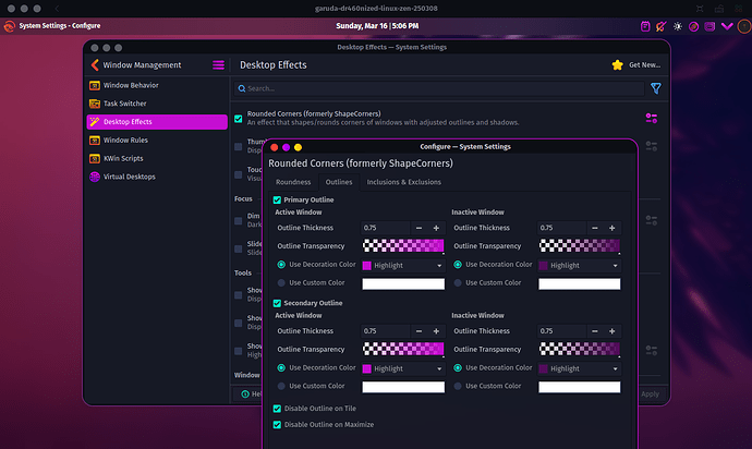

Hello all,
When i was testing the live image of the new version I had noticed that the window decoration had a color around the windows (you can see the photo under the editions from the site), after upgrading the system I cannot find any options to change it to show like how it was on the live imagine.
Any ideas?
Thank you!
Hi yiannisp,
did you checked System Settings–>Window Managment → Rounded Corners is ticked ?
ps which Version you used? The Garuda inxi would help us to see it :wink:
If I understand what you mean, that could be probably the panel colorizer, which creates a border aronud the widgets on the panel when a window is maximized or anyway touches the panel.
If you right click on the panel you should be able to configure it.
It was updated today, so maybe a reboot or logoff could help.

I am not speaking about the widgets I am speaking about the window border (eg. in konsole or dolphin)
Thank you for your answer though.
Reboot and then check this:
In case you have not installed it:
sudo pacman -S kwin-effect-rounded-corners-git
thank you @nepti this wasn’t installed!
Interesting. Almost impossible to say the least since it’s par of the Dr460nized ISO itself.
https://gitlab.com/garuda-linux/tools/iso-profiles/-/blob/master/garuda/dr460nized/Packages-Desktop?ref_type=heads#L31
Since you installed from Live ISO and noticed it was there, something happened just before or during your “system upgrade”. It is not a package that uninstalls itself.
But anyway it is fixed and it was easy, that’s what we care about. :smiley:
He only tested the new Broadwing live.iso, but Bird of Prey is installed:
And kwin-effect-rounded-corners-git did not come via update. It’s the same for me, that’s why I suspected this. :slightly_smiling_face:
Oh, now I see the pattern, yes when Rounded-Corners was added to Dr460nized it was not for already installed systems, as it plays with $HOME config files which we usually don’t do.
