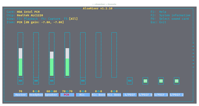

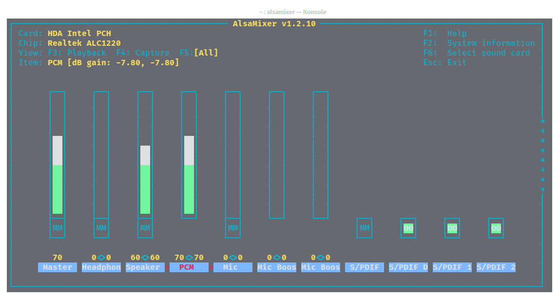

Install alsa-utils (a terminal app), and use alsamixer to unmute the muted channels
Thank you, I have already tried that. Unless I missing something, which I have been known not to find the mustard bottle right in front of the refrigerator ;-).

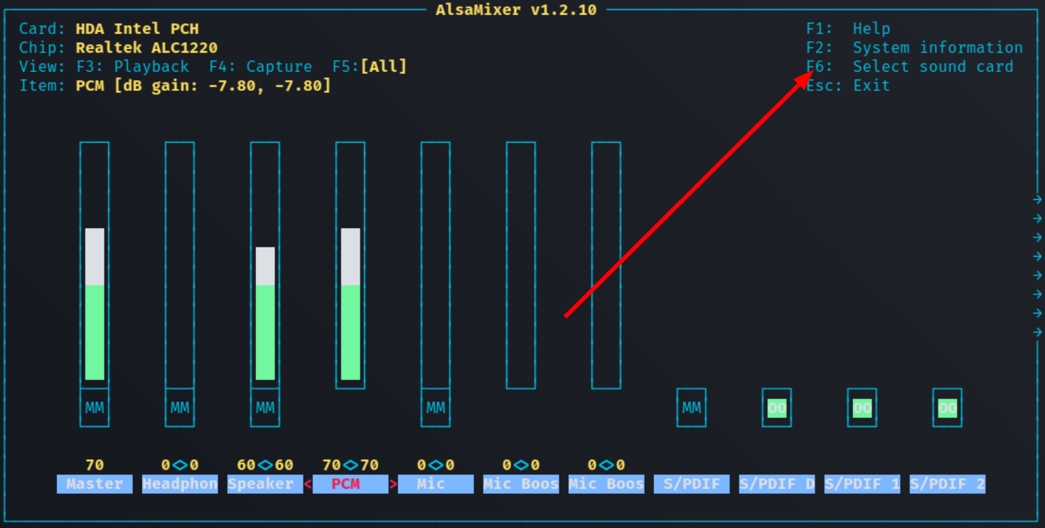

Have you tried pressing F6 to switch to another sound card?
I have seen sometimes the incorrect sound card is in use for whatever reason.
Another consideration would be to install PulseAudio Volume Control:
sudo pacman -S pavucontrol
With pavucontrol you can change output devices (AlsaMixer lets you adjust their volume, but not switch from one to the other). If you have the wrong device selected, that could explain why you are not hearing the sound that is apparently playing somewhere.

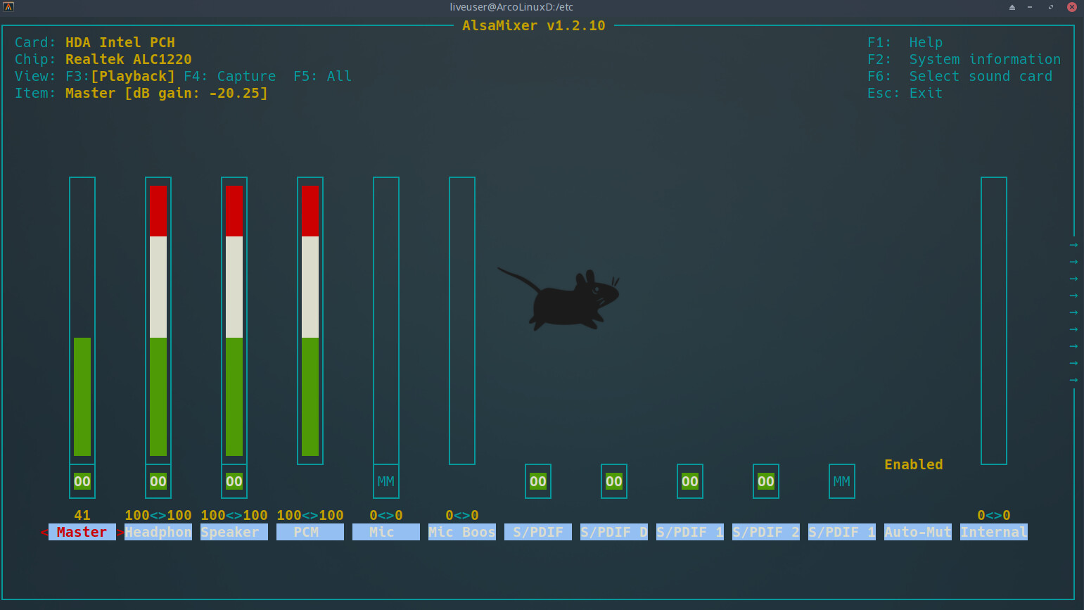

So not sure what to check or what is set. But I just booted off an arcolinuxd iso and audio is working perfect. If I could install this and somehow then covert it to Dragonized that would be awesome.
Under arco:
