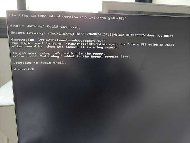

Dracut warning: garuda_dr460nized_birdofprey does not exist
Hi Garuda comunity
When I try to boot with Garuda Dragonized ISOs (The same thing happens to me with the last 3) I get the following error regardless of whether I choose the open source or NVidia driver option:

I downloaded the ISOs from https://iso.builds.garudalinux.org/iso/garuda/dr460nized/
Any help will bi appreciate it
Thanks nepti for the quick reply
I will wait for the next build :smile:
