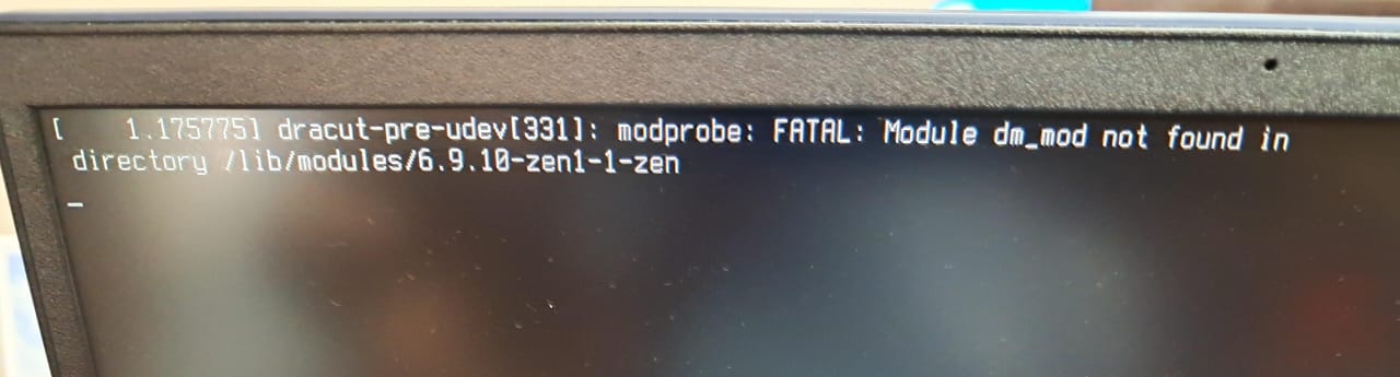

Update , it seems like now it is more an dracut bug , now it is happening even in zen , and when I restored through snapshots and after that , I upgraded again with failed initramfs and then doing a rebuild manually ,
now I am seeing the boot option but it is still not working ,
I guess I would dig a little bit more before giving up :thinking:
Okay , nothing is working , but I found there are some binaries missing
