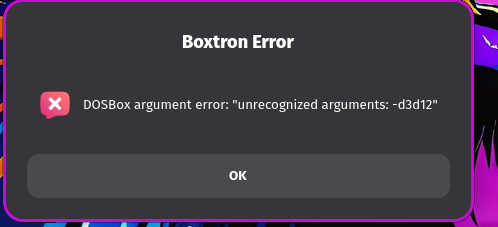

Something issue with steam i do believe also it does reset game windowed/fullscreen options. Everytime i open cs2 i do window and re-fullscreen mouse will go to other monitor but in game mouse stand still.
edit: i manage to remove boxtron what is come with steam. i dont get pop up anymore but my main issue still continue.
Have to agree with the error message, CS won’t run on DosBox… :wink:
Seriously though, looks like Steam is trying to run the game with the wrong compatibilty tool. Config might have gotten changed for some reason.
Check the game properties in Steam, Compatibility tab. Select Proton Experimental. You can also check the default that is selected in File → Options.
Still Same Proton Exp or Proton Hotfix doesn’t matter. Sadly.

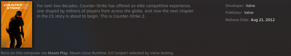

Can you in steam when you are in the game TAB
> click on the small “i” icon and make a screenshot?
There should be mentioned in what compatibility mode is the game running.
Also please if you have any steam launch options for that game set, copy paste them here.
For game not running on steam, usually its the problem of wrong compatibility mode.

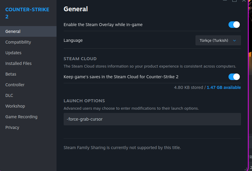

Where i put this in here ?
or is there any sudo pacman --force-grab-cursor thing ?
That is the place. However, note the double dash in the beginning.
I believe you do need gamescope for this, because it is a gamescope parameter. Doing it like @Seimus recommended would send the parameter to the game, which probably doesn’t change anything. But feel free to give it try.
To make it easier: Using gamescope just means using this as launch options:
gamescope -w 3440 -h 1440 -f -r 165 --force-grab-cursor -- %command%
Replace the numbers with your actual screen width, height, and refresh rate, respectively.
Make sure to use this exactly as written here. Uppercase/lowercase does make a difference, the spaces are relevant, and even the double dash before the command placeholder has a meaning.
If the game does not start at all, install gamescope using sudo pacman -S gamescope.
I did install gamescope then i use terminal “gamescope -w 1920 -h 1080 -f -r 60 --force-grab-cursor – %command%” i wrote this without quotes. I even try to do with program name like %counter-strike 2% it didint work out for me. this is error i got:

%100 Sure its a proton issue, i guess i will wait another update ai and google says.
Also i run guildwars 2 from steam i have no issue at all but it does use different type of proton. When guildwars 2 proton on others either i got VAC error or its just same with new proton version.
%command% is a literal. Do not replace this with the program name.
And this command goes into the field in the Steam game properties, you don’t run it from the command line.
When i done that game wasnt loading at all. Its okay i will wait update.
I know it’s not exactly a ‘fix’, more like a band-aid, but you could always change your monitors layouts in the kde settings, put one screen in the corner of the other, just conected by the vertice, that will make it quite hard for your mouse to wander to the other screen.
Now, u can do this setup only when gaming, or leave it that way, it takes some time to adapt, but it is fine. You can still move your mouse to the other screen, it’s the setup I use.
