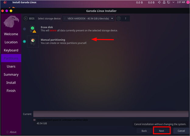

Does installing with manual partitioning work like this?

I don’t think you need manual partitioning??
I once installed Hyprland using this same video on a 64 GB HP Pendrive with automatic partitioning. In your case, the bootloader will automatically install on the SSD, and Windows should be untouched. Just changing the boot order in the BIOS will work.
Ah, so you meant that using erase disk and selecting the SSD should do the work ?
I did that with Eos and Manjaro, but I thought it was different here:
So not following the arrow but the other option
This would be great news :slight_smile:

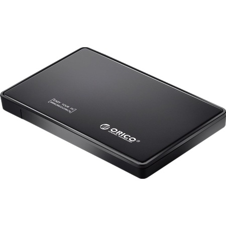

It’s actually a orico rack and an SSD I’m looking to get cuz the other one has windows 11 pe installed for my old laptop , I already have/ used the rack , I just need the new SSD

Would it be way more dangerous to do it in the other way,as the other user said: through selecting delete and selecting the SSD? ( As I uploaded the picture?)
I could let Calamares do it, but… I’m a bit sceptical about it :confused:
Anyway,thx for explaining how this works
Both options are OK and both work (it’s standard Calamares stuff).
