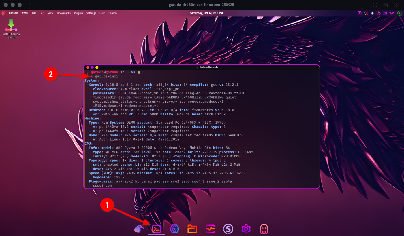

Boot the live iso and post then the garuda-inxi. Open konsole / terminal → garuda-inxi or use rani to do this.

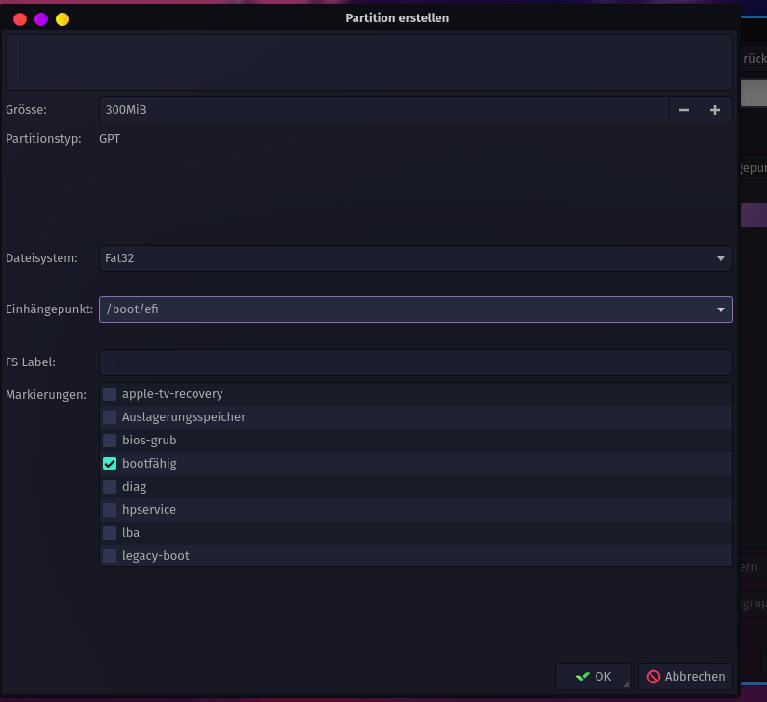

That’s not a must.
Only / = btrfs isn’t enough. You must have a bootable uefi partition for the boot loader.
Without, it’s impossible with your system to boot into garuda linux.
That is / was your mistake. You have to created a partition vfat32 size 300MB, bootable and mounted as /boot Default is this partiton on the beginnig of the drive.

The warning you mentioned was probably about the 300 MB pre-load/boot area, but I didn’t know how to create it, so I just proceeded. I don’t have much knowledge about Linux; Windows usually sets up the boot memory and settings on its own. Therefore, it would be very helpful if you could explain step-by-step how to set it up. There aren’t many forums or sites with information about Linux, or people with knowledge about it, in my region, so it will be difficult for me to search and find. I would appreciate it if you could help me.
The installer app, calamares, did everything for you if you point to a (free) partition on your hard drive, it’s just easy.
No need to create or format /, /boot/efi and so on.

Then copy the entire output that follows, open the Firedragon browser in the live environment, log in to the forum, and paste it here.
Where and how can I get the application you mentioned? Is it possible for you to send me the download link for how to use it?

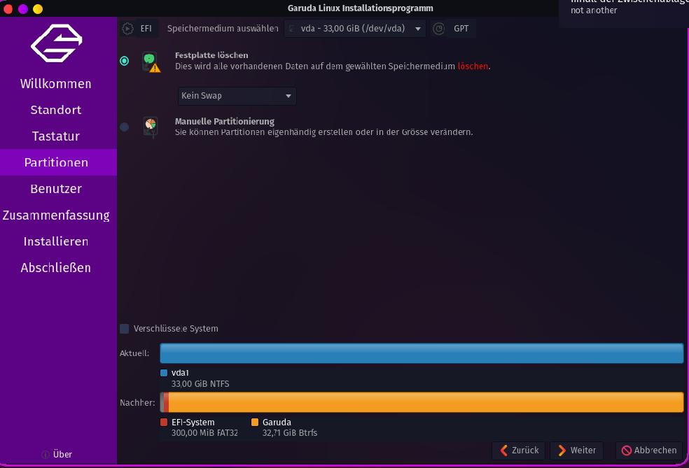

You don’t need a download. All you need comes with the live iso. (Pictures from nepti)
But only if he use the windows drive, not another.
Then he “must” make this manual or can “only” delete. (my mind)
My example on a vm dr460nized with gpt partition table + ntfs partition.
Only two options exist.
Inside the step manual it is then possible to make the right settings.

Now these were written in the console. What path should I follow?
This is the live iso. :wink:
