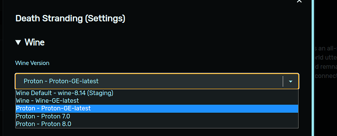

Try running the game with proton. Generic wine doesn't have a lot of game compatibility.
If that still doesn't work, try installing vkd3d (I'm not sure if this is required, but it'd definitely be worth a shot)
Also check if you have the nvidia vulkan drivers installed
do I have do change anything more than the option in Heroic?
I tried that:
and... this time it worked? wtf? O.o I swear I had tried this yesterday and it didn't work!
