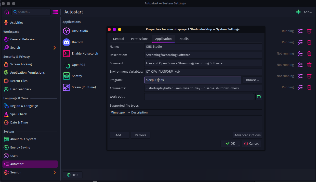

Delay application setup at boot
HI. i use OBS to capture instant replays and use noisetorch for noise suppression. However OBS starts before noisetorch so it does not use the right sound device.
Is there anything i can add to the desktop entry to either delay OBS, or start noisetorch quicker?
Thanks

Change the obs command in KDE Settings / Autostart applications / OBS / properties (or something similar).
Prepend Command with sleep X; (delay in seconds). E.g.
sleep 3 ; <program name>

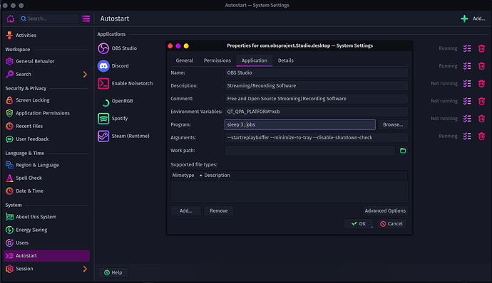

so like this?
I didn’t even know this was possible.
My VPN always takes slightly longer than one of my apps that requires an internet connection to refresh so it fails to refresh. This should fix the issue. Thanks!
After doing this OBS no longer starts at boot
If you mean that OBS autostarting fails, you should try quoting and escaping of the Exec key value. IIUC, ; is a reserved character.
Here is the relevant part of the Desktop Entry protocol for the Exec key:
Arguments may be quoted in whole. If an argument contains a reserved character the argument must be quoted. The rules for quoting of arguments is also applicable to the executable name or path of the executable program as provided.
Quoting must be done by enclosing the argument between double quotes and escaping the double quote character, backtick character (“`”), dollar sign (“$”) and backslash character (“") by preceding it with an additional backslash character. Implementations must undo quoting before expanding field codes and before passing the argument to the executable program. Reserved characters are space (” “), tab, newline, double quote, single quote (”'“), backslash character (”"), greater-than sign (“>”), less-than sign (“<”), tilde (“~”), vertical bar (“|”), ampersand (“&”), semicolon (“;”), dollar sign (“$”), asterisk (“*”), question mark (“?”), hash mark (“#”), parenthesis (“(”) and (“)”) and backtick character (“`”).
Seems to work fine now. Thanks for the help.
