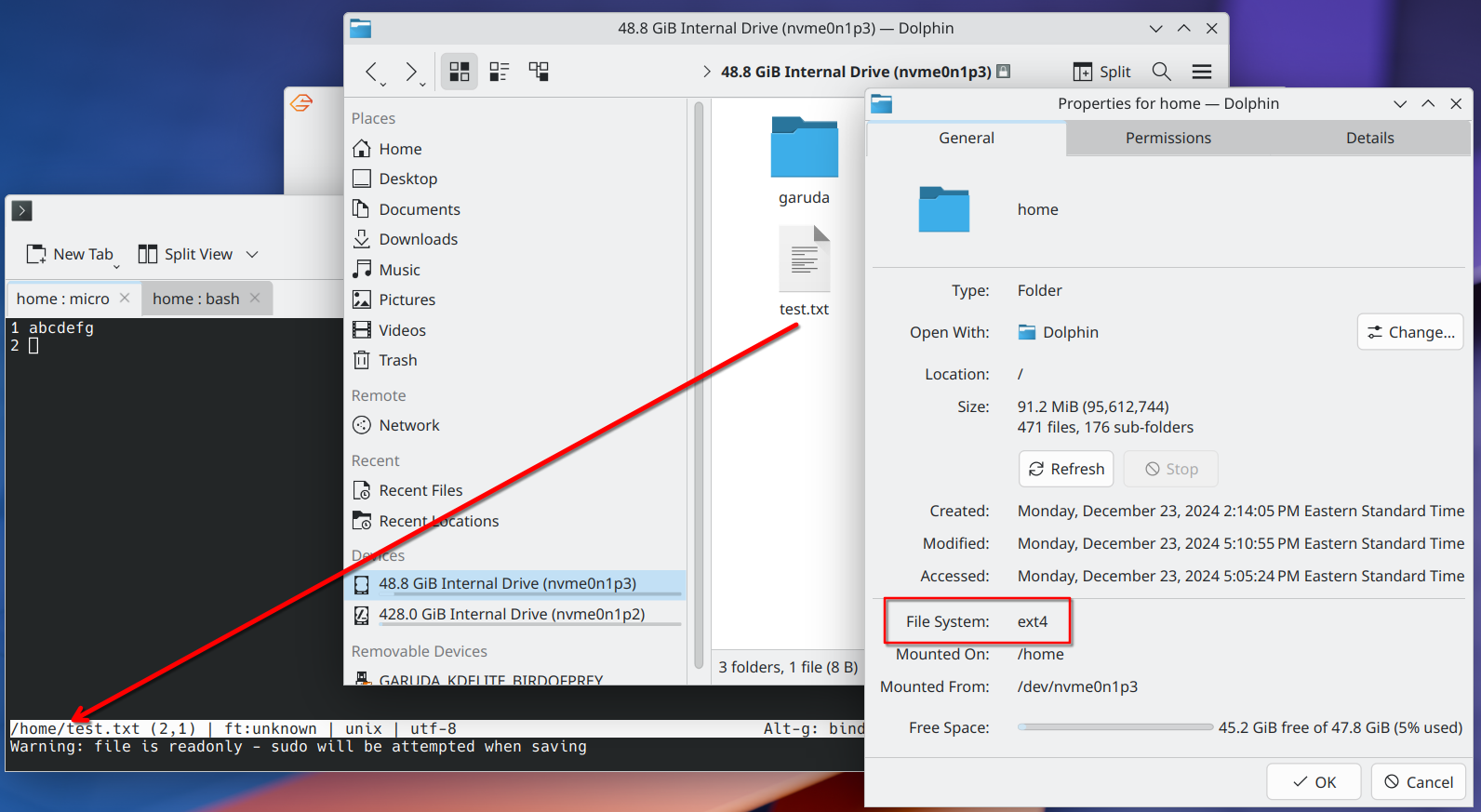

I tested and cannot reproduce this behavior. In my case the contents of the ext4 home partition were preserved as expected.

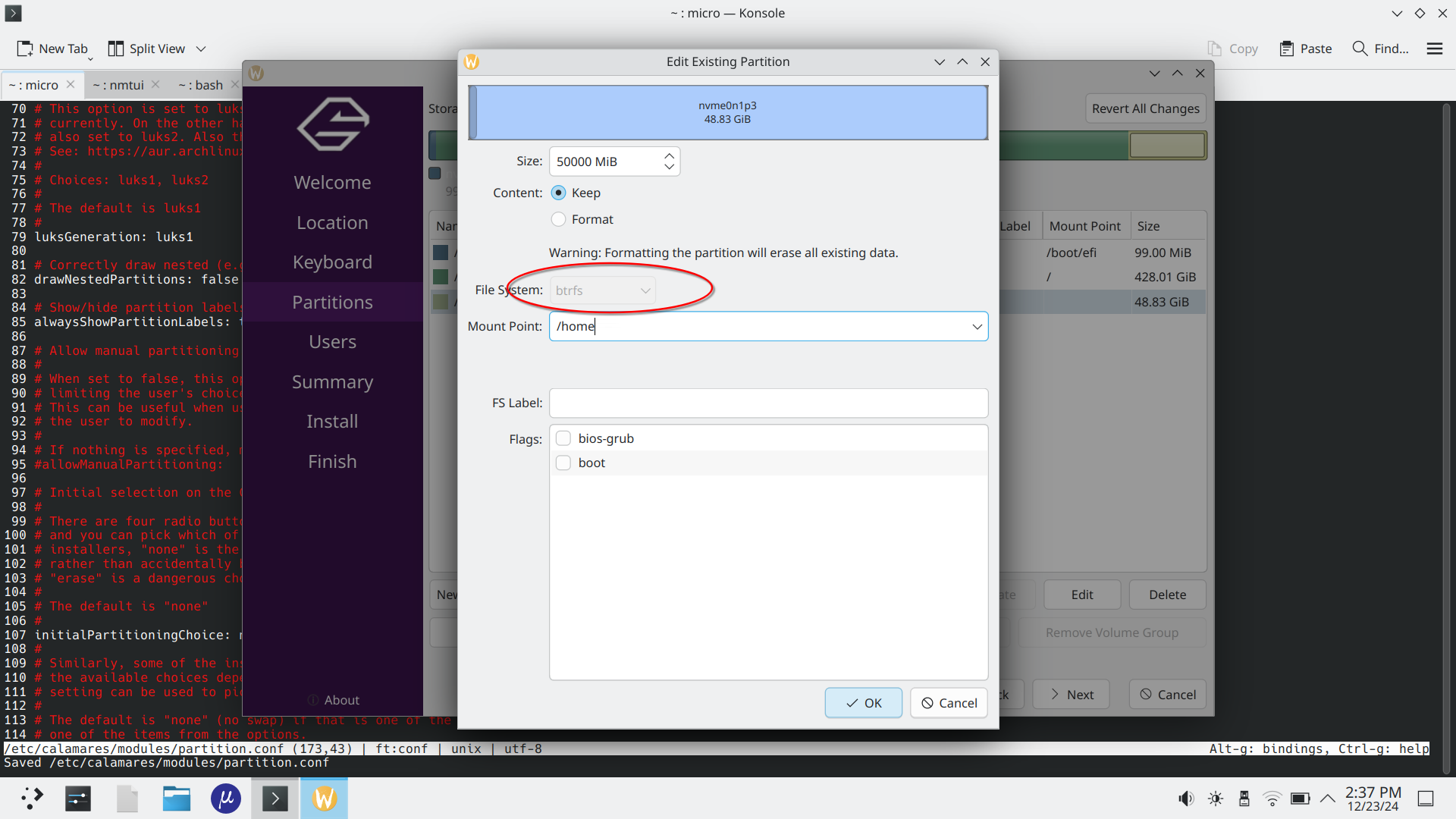

I did notice a bug in the UI. When I opened the ext4 partition to set a mount point, it incorrectly shows Btrfs for the filesystem (although on the partitioning menu it was correctly identified as ext4).
I’m not sure what that was all about.
Before installing, the overview correctly indicates that the ext4 partition will be set up with a mount point–it will not be formatted, no filesystem change.
When I reboot to the installed system, this is confirmed. The ext4 partition is mounted on /home, it is still ext4, and a test file I added before running the installer is still there–no data lost.

The Calamares installer has been intentionally configured to only offer Btrfs as a filesystem when using the “erase” or “replace” installation types. There is no filesystem selection option at all, in fact:
The benefit of setting it up this way is it automatically eliminates all the issues that would inevitably be raised in the forum when someone chooses ext4 for their filesystem. “The snapshots are not working”, “I get all these messages about failed Snapper services”, and so on.
For advanced users who understand the implications of changing the filesystem this way, you can still install with ext4 by editing /etc/calamares/modules/partitions.conf before running the installer.
micro /etc/calamares/modules/partition.conf
Uncomment the availableFileSystemTypes line and add the filesystem choices you want in there.
availableFileSystemTypes:  ["ext4","btrfs"]
Save and exit the file, then when you start the installer you will have the specified filesystem options available.
