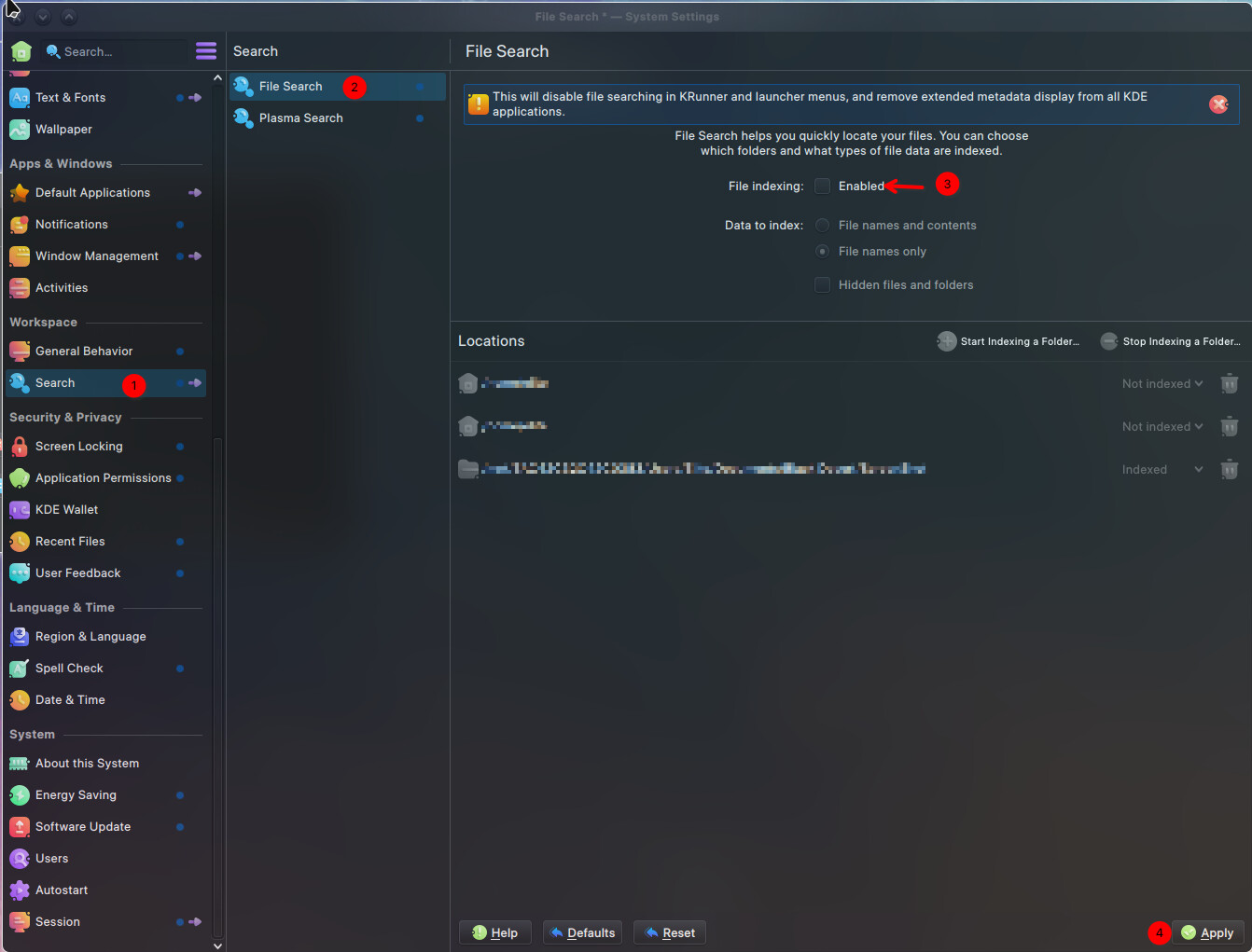

Is baloo file indexer running? You might want to try turning it off. Baloo - ArchWiki , it can also be done with the gui as well you may have to restart for it to take full effect if you do it from the gui.
Might want to do some research cause the KDE finally beat it into submission.
