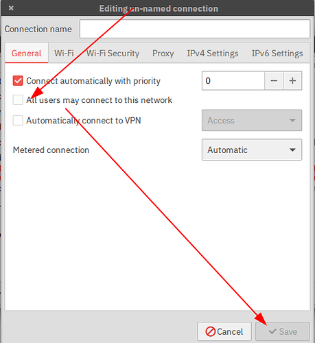

Yes, e.g.

It doesn't appear to work, it still waits for me to sign in before connecting to the network..
That's definitely the correct approach:
https://wiki.archlinux.org/index.php/NetworkManager#Connect_to_network_with_secret_on_boot
Read that and try again?
Did you disconnect Kwallet?
Read it. I hadn't stored the password for all users, was the problem. Trying again now.
Problem solved :slight_smile:
Also for others benefit, be sure to either log off, restart Network Manager, or reboot after making the changes within Network Manager.
