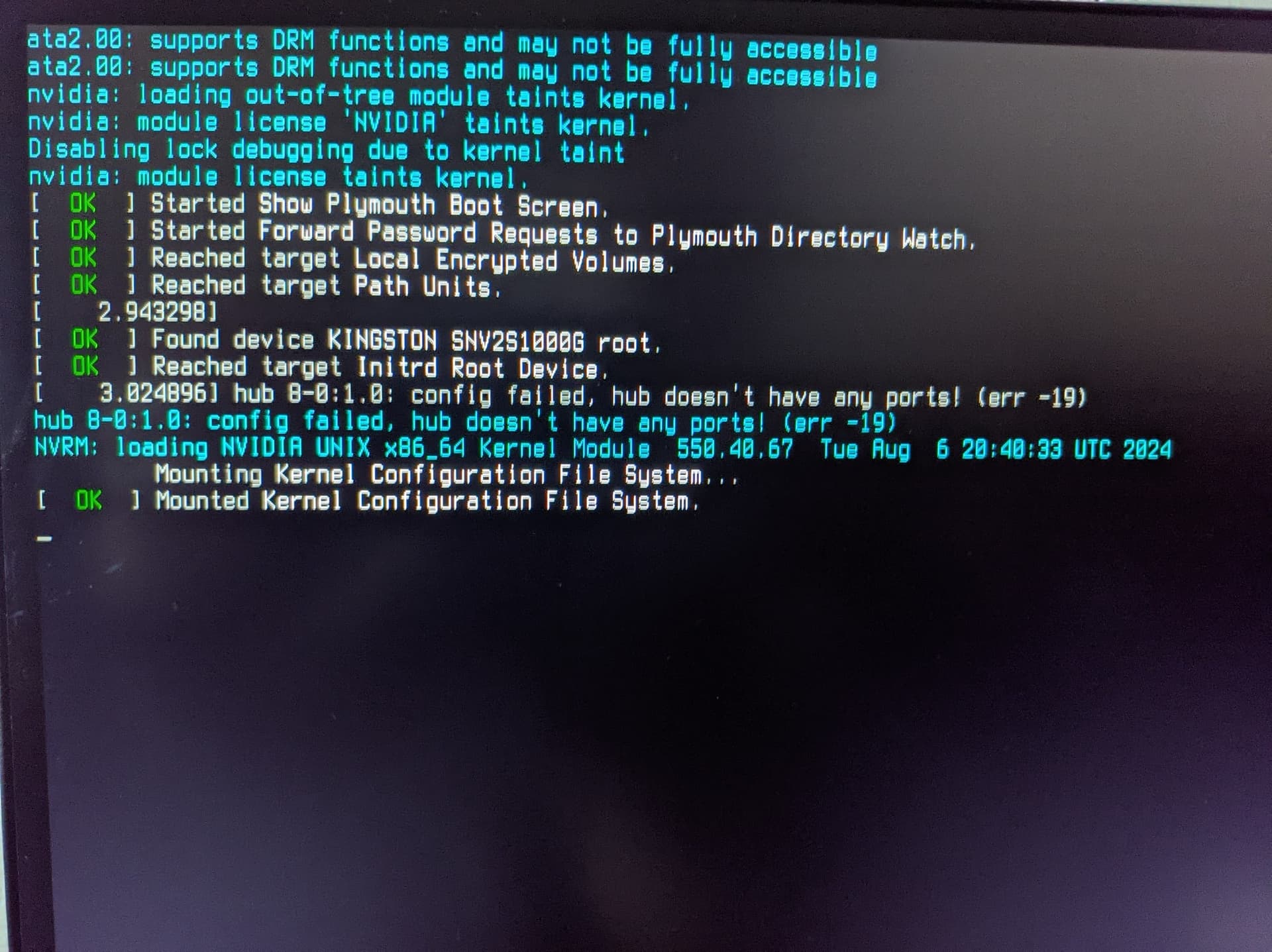

I did a garu-update yersterday, and since, when I turn my PC off, I get the GRUB, but the PC can’t charge Garuda.
Failsafe mode get me the same, in recovery I get this (sorry for the picture, no other way to copy).

First off, you should try restoring the latest working snapshot.
Then you could try again (you never can say), if necessary restore again and e.g. try a different kernel (LTS) and update again.
Additionally, after restoring you’ll have a chance to provide your garuda-inxi.

I’m not an Nvidia user, so cannot help much.
Did you take the chance to try a new garuda-update?
Make sure you restore the snapshot you booted and reboot before trying again.
This should be the reason for:
and
Your Nvidia driver v: 550.40.67 seems old, isn’t it?
If I do a garuda-update again, I get the same result, black screen, fan going full speed continuously.
The reason for the boot_image was that I took the inix with the working snapshot.

How do you update your drivers?
This still looks strange to me:
I see from the Nvidia website they suggest 550 for your model, but directly installing from there is discouraged.
I think you should use nivida-dkms , currently v: 565.57.01-2.
But, as said, I’m no Nvidia user, so probably some will know better.
I tried to update via there website, but it doesn’t seems to be tacken into account…
If I try to install nvidia-dkms, it tells me that there are dependencies broken:
deleting nvidia-dev-utils-tkg break the dependency "nvidia-utils-tkg" required by lib32-nvidia-dev-utils-tkg
deleting nvidia-dev-utils-tkg break the dependency "nvidia-utils-tkg" required by nvidia-dev-egl-wayland-tkg
deleting nvidia-dev-utils-tkg break the dependency "nvidia-utils-tkg" 550.40.67 required by nvidia-dev-settings-tkg
Sorry, I’m running short of time now.
In a few words, you have to manage to remove, forcibly if necessary, all that tkg stuff: nvidia-dev-utils-tkg, nvidia-utils-tkg, nvidia-dev-settings-tkg, etc.
Try this code;
(A lot of Nvidia cards are running into troubles lately. There are different solutions. Try this one first. It installs open source dkms modules, which seems to be the trouble of many. There are other solutions, if this one does not work.))
sudo pacman -R garuda-nvidia-config garuda-nvidia-prime-config && sudo pacman -S nvidia-open-dkms
Hmm, when I try your line, I get the following
error : impossible to find the target: garuda-nvidia-config
error : impossible to find the target: garuda-nvidia-prime-config

Okay that doesn’t seem to work at all then.
The following code is what has rescued me many times, though i have been told not to use it.
It is downloading the Nvidia-all drivers and trying out different versions of the Nvidia drivers to see which one would fix your issue, if any.
You might want to try, line by line, and see if this will fix it for you. (i watch the compiling of the dkms modules, on my terminal, to determine if a version works. If there are no errors things ought to work after that.
git clone https://github.com/Frogging-Family/nvidia-all.git
cd nvidia-all
makepkg -si
sudo dracut-rebuild
sudo update-grub
So I tried with the vulkan-dev (550.40.67), because it’s the one I had before, and even it block and tell me to force (-f), if I do, I get the error:
An error occured in build()
Abord
Same result with the other 550.110 sadly
Okay, that is a real bummer
another thing you might not have tried is to let remote update fix it
garuda-update remote fix
Okay, I went back to an old snapshot, updated manually the nvidia driver, then garuda-update remote fix and it works!
