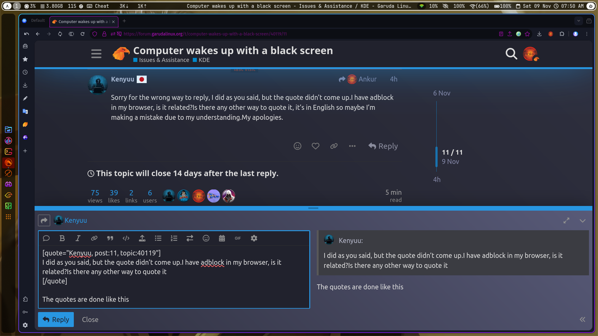

Sorry for the wrong way to reply, I did as you said, but the quote didn’t come up.I have adblock in my browser, is it related?Is there any other way to quote it, it’s in English so maybe I’m making a mistake due to my understanding.My apologies.
The quotes are done like this :
/OT
