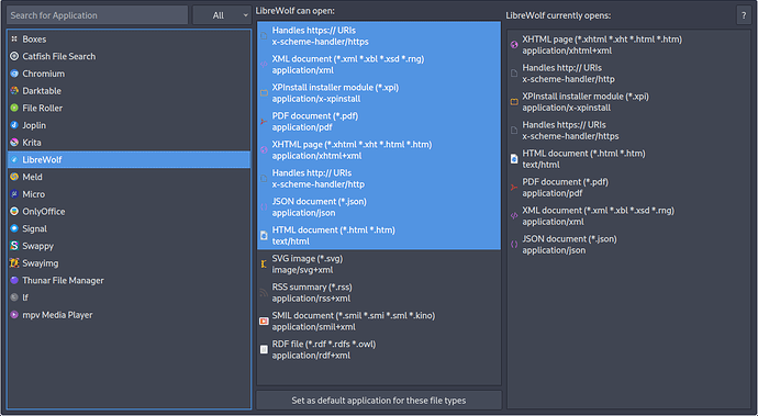

Before I go on a kinda rant: Is there a simple way of doing this I am just not seeing? (I found a solution…but it’s 4 years old and kind of buried)
This seems like something that should be in Rani/Welcome right under choosing my default shell. (yay! fish! I was an instant fanboy after discovering that)

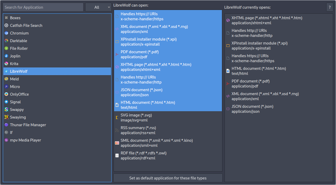

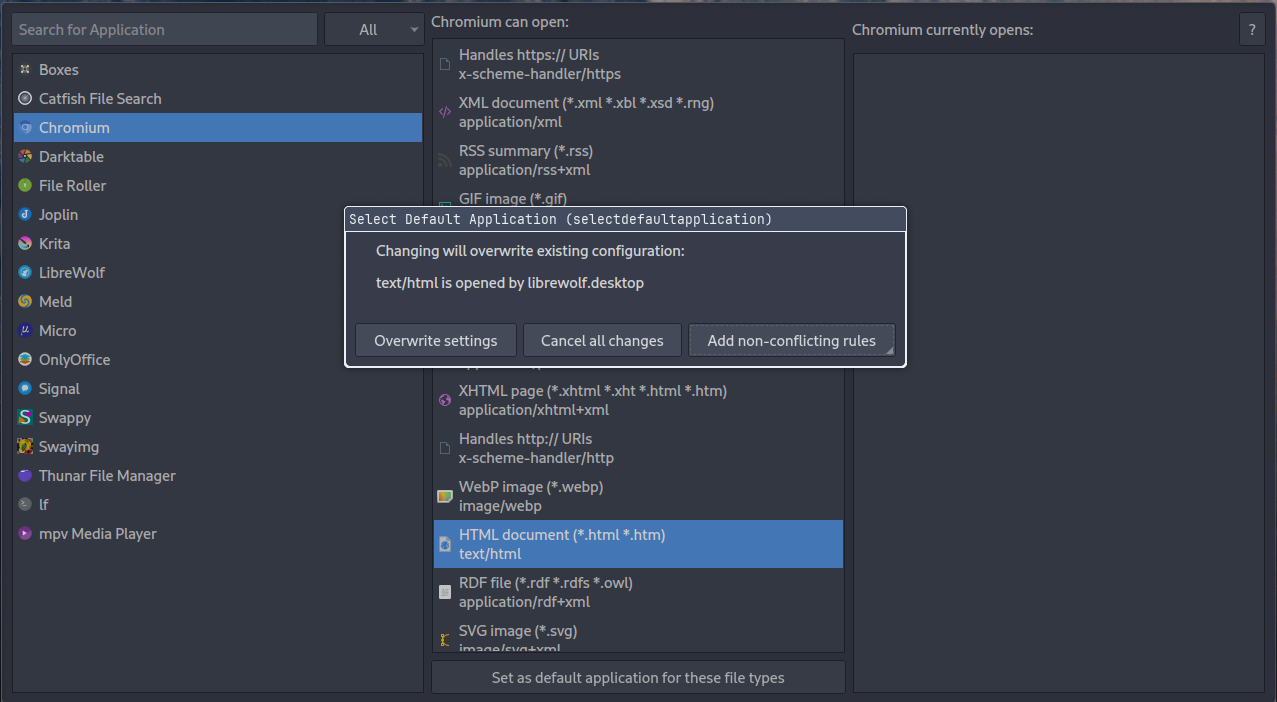

More current note to self on the only working solution I found:
xdg-mime default <YOURBROWSERHERE>.desktop x-scheme-handler/https
On fresh install .config/mimeapps is effectively empty. I still have no clue where firedragon was persisting, no matter how I set BROWSER or used xdg-settings
