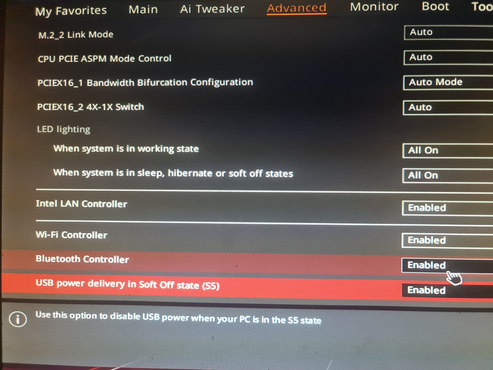

You can Disable it in the Asus BIOS Settings. I can disable it and even my wifi too.
you also can update the bios if the function is missing:
 date: 08/31/2018
you can uninstall Lactd if you dont need it . (Rani) I dont know if its support intel gpu. i use for my amd.

how do I update the bios on linux
You’ll have to refer to your motherboard manufacturer’s instructions. @Duke187 posted a link in this comment: Changing the default bluetooth adapter from the built in Realtek card to a USB bluetooth dongle - #2 by Duke187 to the ASUS website for your model. There’s likely a firmware file you can download and save, then when you boot into your BIOS/UEFI, you’ll find an option to upgrade.
Would doing that also kill the WiFi module ? because they share the same name
Oh…mmmmaaaaayyyybbbbeeeee yeah… If you can disable BT in your BIOS, that may actually solve the problem.
I’ll check the bios out then . The bios had no option to disable the bluetooth driver
Sorry, I’ve now reached the limits of my knowledge/understanding. You may have to add a wifi dongle as well.
Edit: perhaps there’s something here that could be helpful: https://www.reddit.com/r/linuxquestions/comments/1jvfupg/any_way_to_disable_just_the_wifi_part_of_a/
