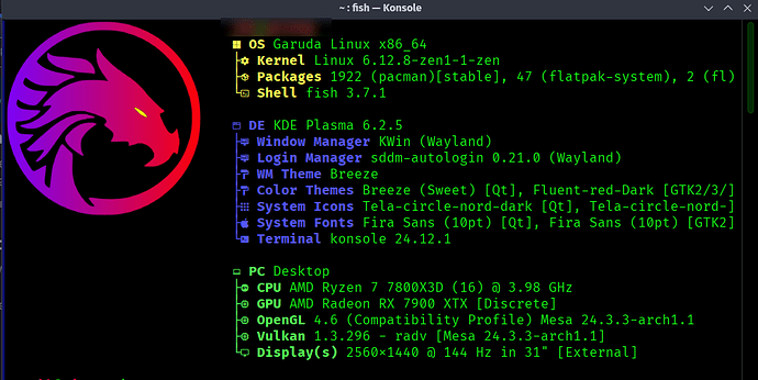

On the first garuda install I performed the bird of prey displays when opening the terminal, but all subsequents(I install this a LOT, its my benchmarking/burn in distro and my Daily Driver) just have the garuda icon instead, how does one make them all display the righteous bird of prey!!
What I want!
What I get…
Thanks for understanding my childish antics, and thanks for the help

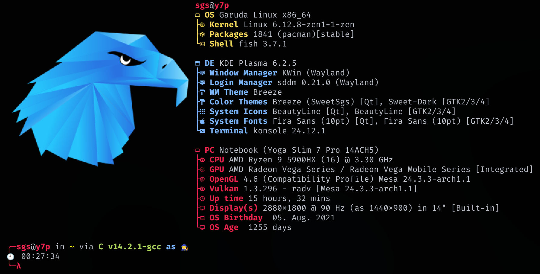

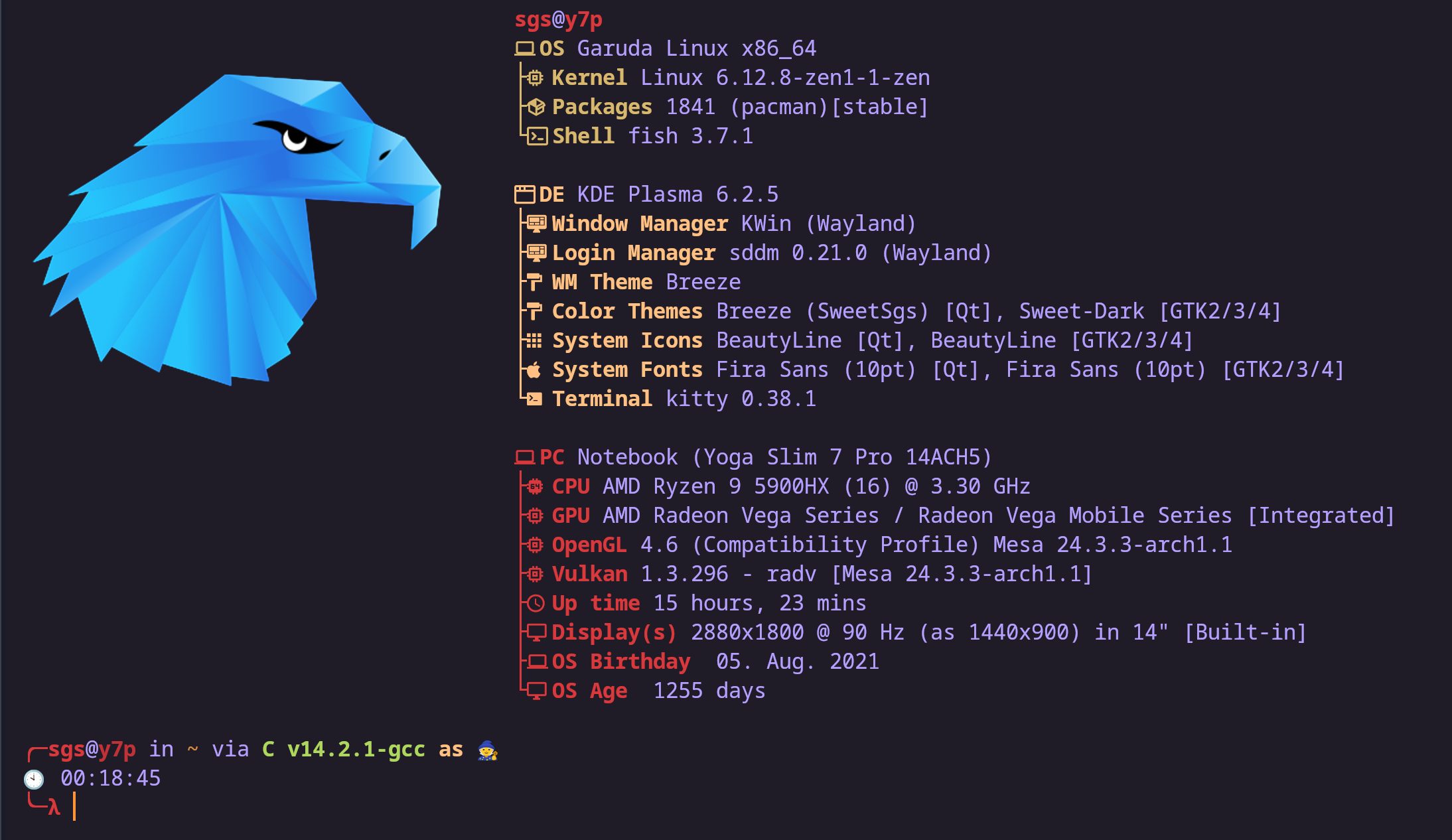

Check your config.fish and edit .jsonc file
## Run fastfetch if session is interactive
if status --is-interactive && type -q fastfetch
fastfetch --config .config/fastfetch/dr460nized.jsonc
end
GitHub - fastfetch-cli/fastfetch: A maintained, feature-rich and performance oriented, neofetch like system information tool.
I just needed
fastfetch --config dr460nized.jsonc
I also tested the other preset to see the best one
SGS
12 January 2025 08:23
4
Just make an alias and do not forget the c
alias ofast 'fastfetch --config dr460nized.jsonc'
thanks for the catch I updated it
I added
and it displays the dragonized but the old G displays after it so I have done something incorrectly.
How to replace it so old G doesn’t show?
check the jsonc file and make sure that this line is in there
"source": "/usr/share/icons/garuda/dr460nized-fastfetch.png",
Also you might have to change
~/.config/fish/config.fish
to include
fastfetch --config r460nized-fastfetch.jsonc
end
or what ever terminal you use
