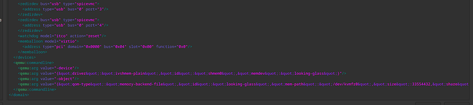

In looking at livbvirt logs I noticed DMA errors. After the most recent QEMU upgrade all my vm .xml configs smacked these lines with see below “Current: (corrupt)” this for some reason:
After the replacing the lines, it puts them back to the marked up “Current: (corrupt)” version. I think this is the issue but not sure why or how to stop it.
The VM will run and I hook up a monitor to it, I just can’t use looking glass now.
Here is the setup doc to follow and its been working, but it clearly hates something now.
https://looking-glass.io/docs/B7-rc1-21-ecd3692e/ivshmem_kvmfr/
Current: (corrupt)
See screen shot:
What it should be:
qemu:commandline
<qemu:arg value=‘-device’/>
<qemu:arg value=‘{“driver”:“ivshmem-plain”,“id”:“shmem0”,“memdev”:“looking-glass”}’/>
<qemu:arg value=‘-object’/>
<qemu:arg value=‘{“qom-type”:“memory-backend-file”,“id”:“looking-glass”,“mem-path”:“/dev/kvmfr0”,“size”:33554432,“share”:true}’/>
</qemu:commandline>

insmod: ERROR: could not load module kvmfr.ko: No such file or directory
Narrowed it down to this error, can anyone direct me on how to fix this. I am missing my looking-glass ;-).
