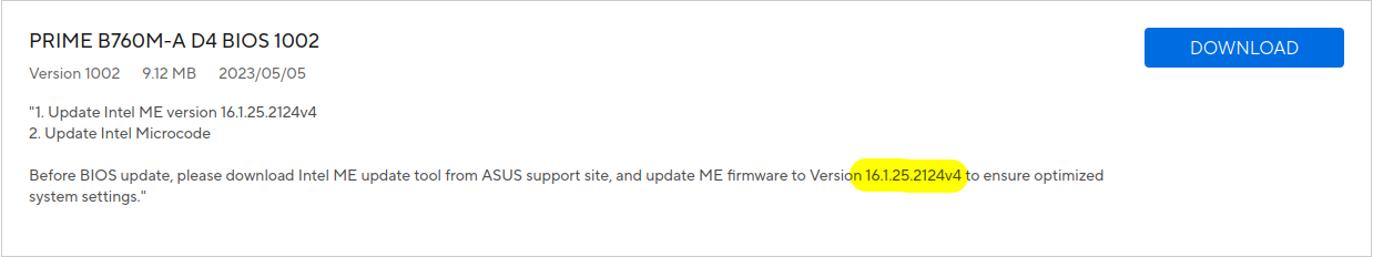

Yeah I recommend doing that I went online looking for your mobo and found it has gotten some stability and security issues addressed in bios updates that you don’t have.
Check it out if this is your mobo and right bios for it do update to it’s latest version.

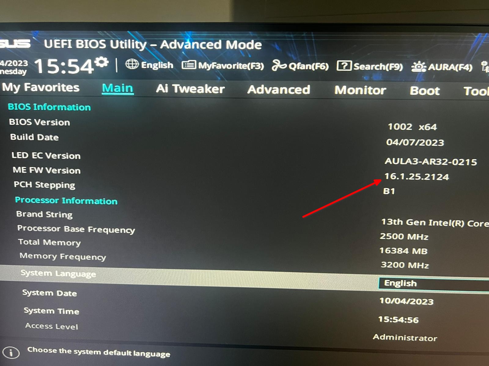

So, i looked the version and its fine for me…
this is the version on thier web site
and this is mine
