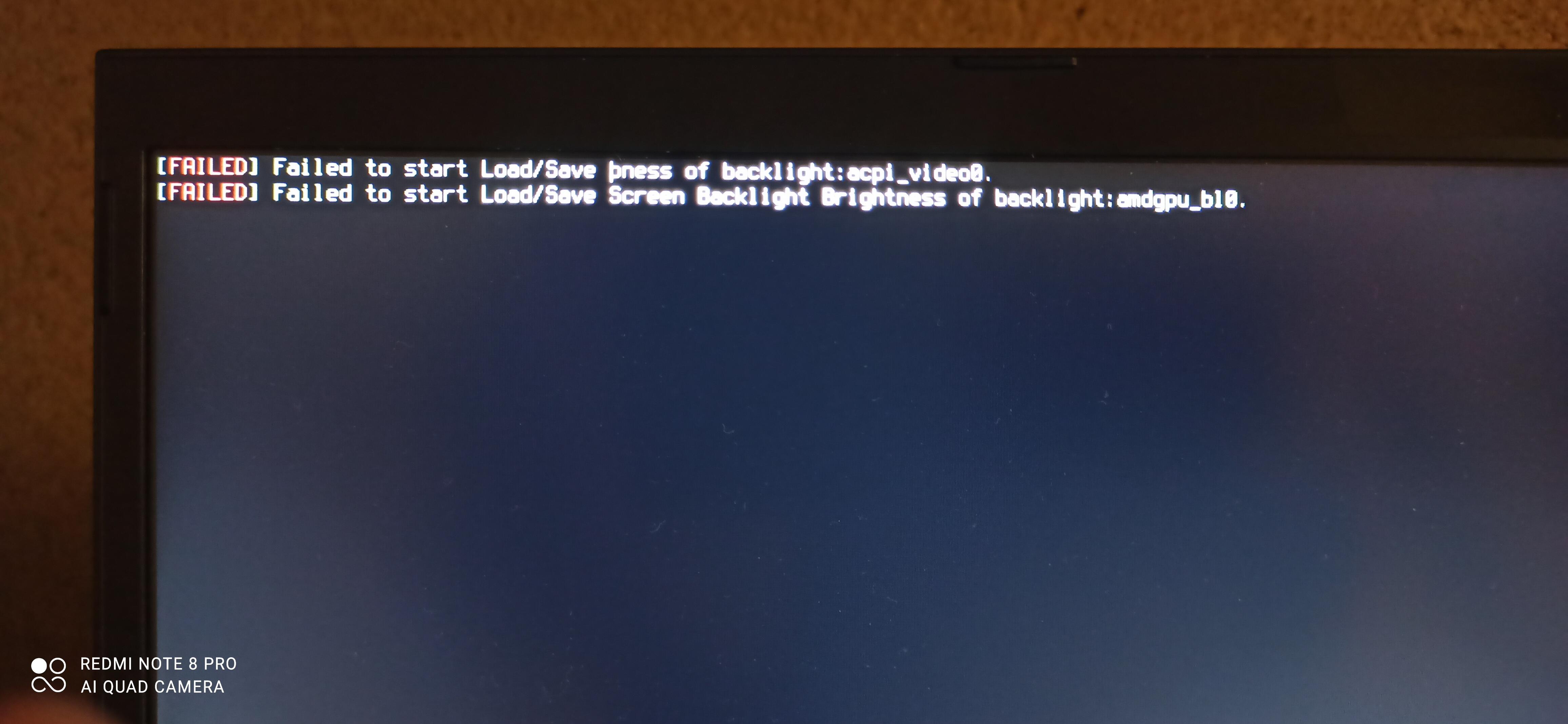

Okay, I installed those two packages (the other one was already uninstalled) and checked there were no *.conf files in that folder nor xorg.conf in the parent folder. Now it doesn't boot, just shows this.
