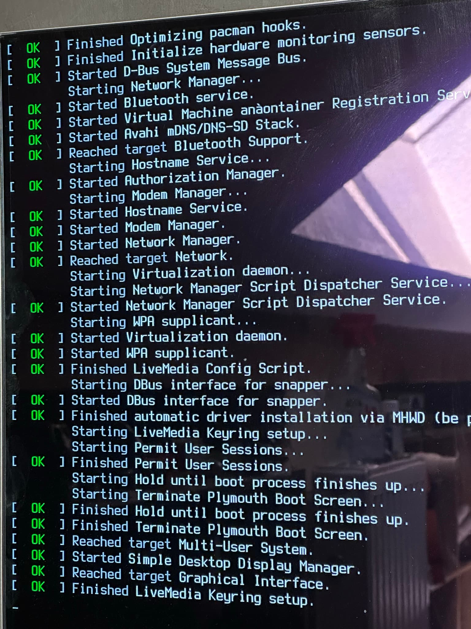

Hello !
I finally manage to get some texte on my screen but I’m still stuck…
The 3 last lines are :slight_smile:
  • Ok / Started Dekstop Display Manager
  • Ok / Reached target Graphical interface
  • Ok / Finished LiveMedia Keyring setup
And then nothing more… just stuck.
I try this with both free and Nvidia drivers but the issue still the same.

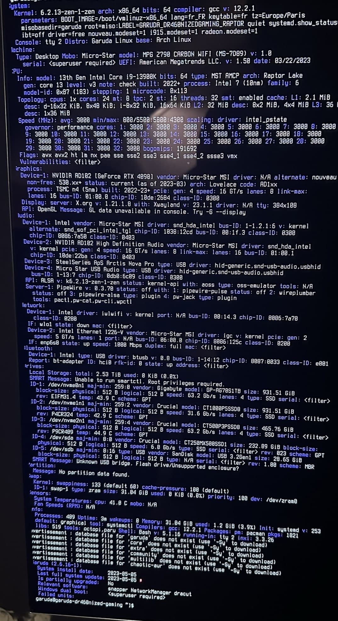

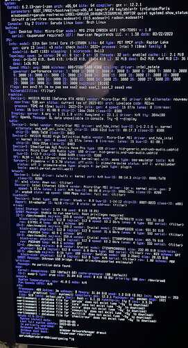

I also manage to use : Garuda-inxi
