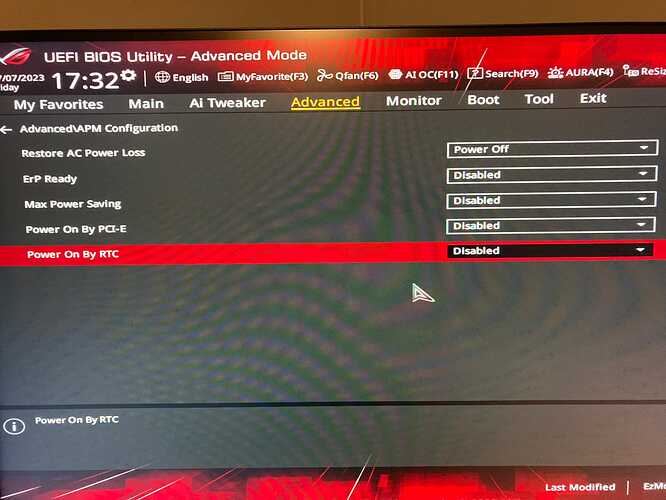

I looked through the bios settings and did not find anything specifically by that name. These are the APM and power related settings I did find, and all were off by default.
I also have updated and plasma is 5.27.6.
