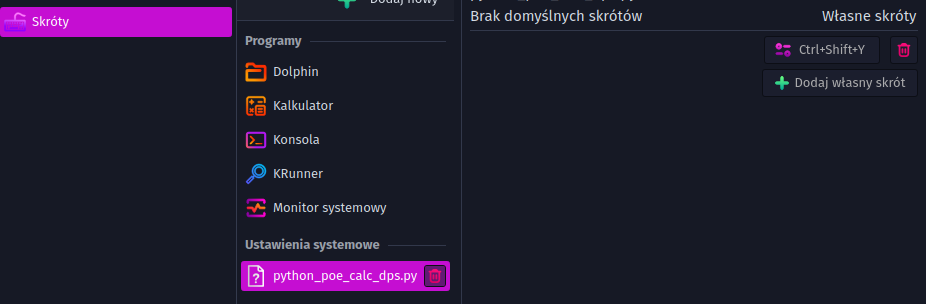

i think you might have same issue as i do, are you using wayland session, have you tried that with x11?
for wayland keyboard shortcurts are not working properly on plasma 6 but i think its more issue of wayland because x11 works for me
i have setup dummy python script to a keyboard shortcut CTRL + SHIFT + Y, after executing it works

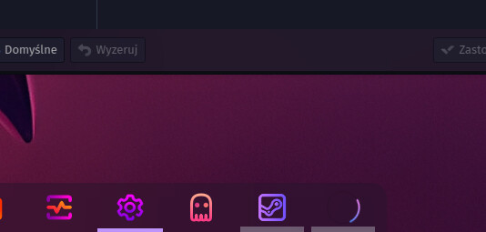

on bottom screenshot, at bottom right is a rounding icon,
but what i have checked previously it will only work when you focus (click on shortcut window and it’s opened) on window, on x11 it works normally but on wayland not
