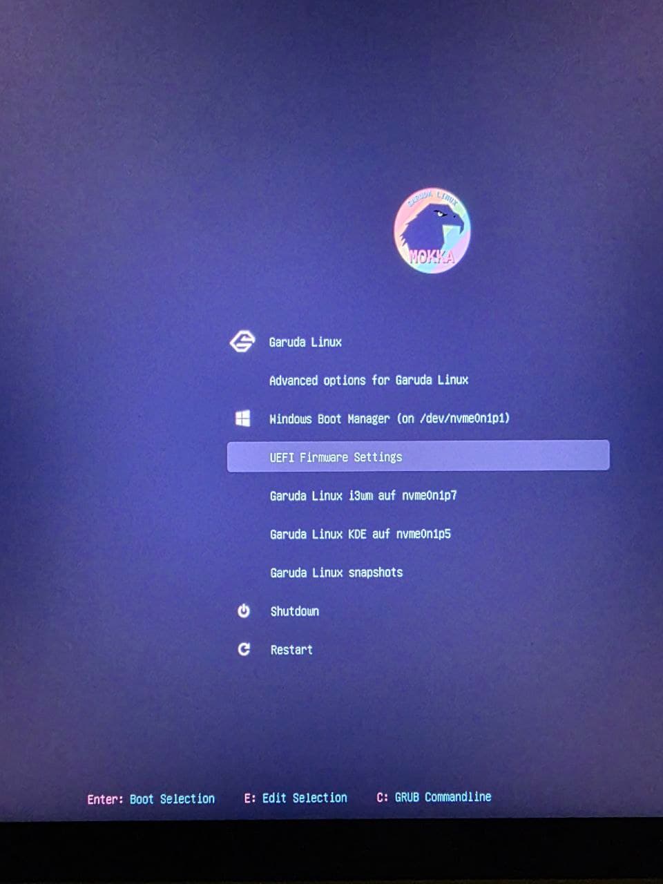

There is no entry in grub for UEFI Firmware settings (BIOS), like in Garuda Mokka?
I do not use GNOME, sorry :slight_smile:
