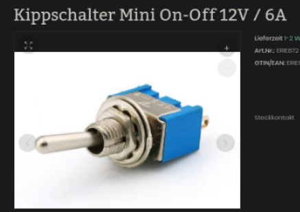

Many decades ago, I simply cut off the power supply with self-soldered cable connections to the power supply using a toggle switch that I inserted into the PC case. Later there were racks where you simply pulled the hard drives out of the case so that they didn’t get any power. Better versions could be protected from accidental removal with a lock. Today everything is much faster with nvme, and easier to repair if problems arise.

Ha, ha, I thought I was the only one who used to do that. I used mini toggle switches mounted to the plates used to fill empty slots on the back of the computer. That way I didn’t have to drill out the computer case itself. I think I had up to 4 drives able to be toggled on and off on one computer
