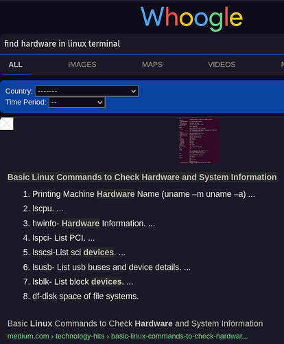

Check Hardware with
lsusb
First thing in Linux is, learn to search ![]()
