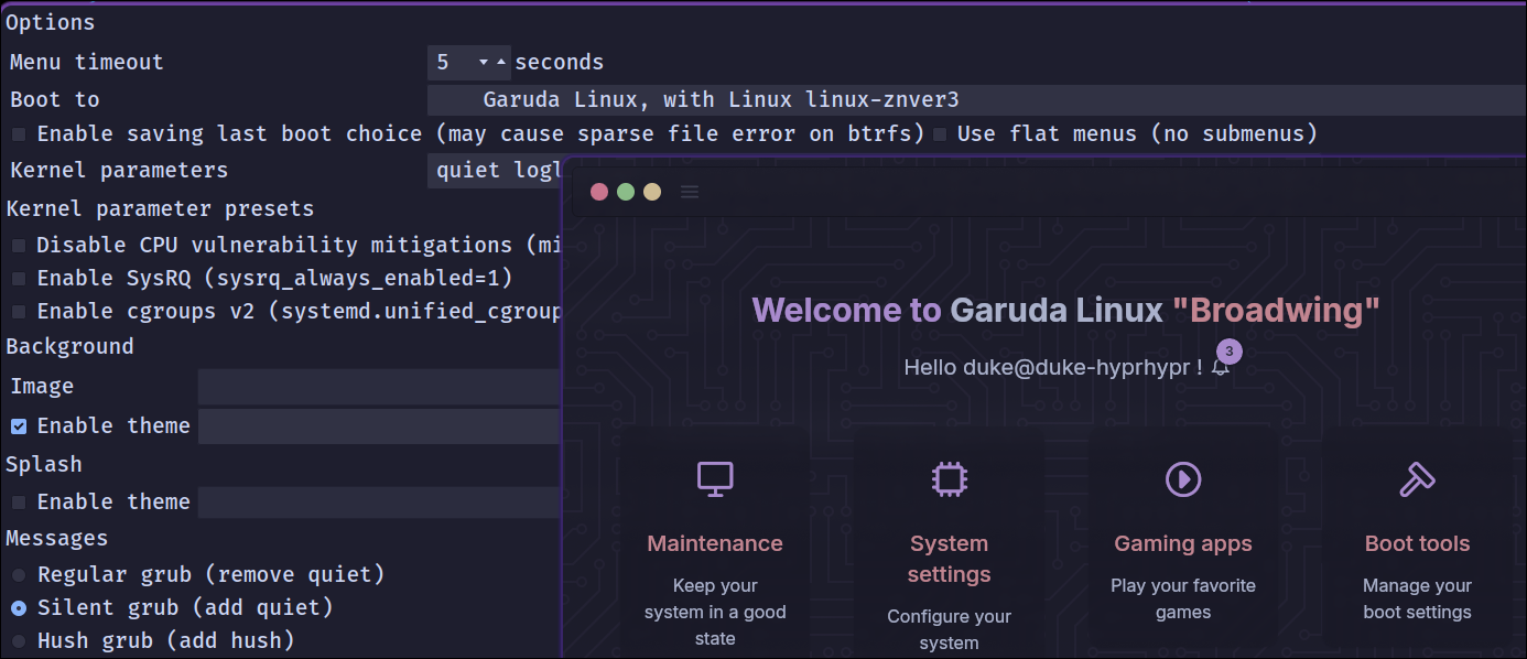

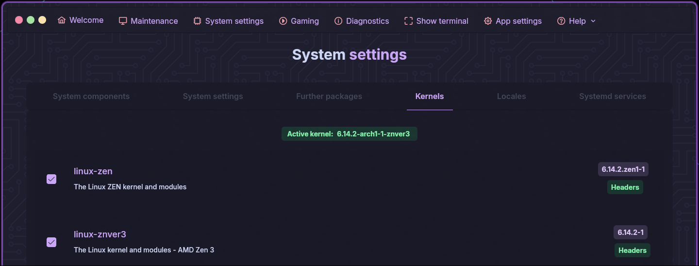

The actually Zen Kernel isnt bad so you dont need to change it. Also i would not uninstall it because use it as a fallback kernel if you messed up something.
Please open Garuda Rani if you want install other Kernels under System Settings >>> Kernels >>> znver4 tick it and execute it.

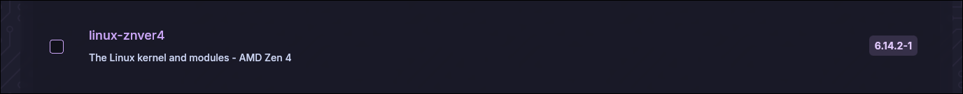

i have a zen3 cpu not an zen4 like you so you look for it scroll down to find it. Also you see i have not uninstalled the zen main kernel. as fallback Option.
your one
then
Screenshot_12-Apr_04-40-51_18125
after the installing reboot your system and on my system the znver3 loaded itself you can see on the display message before the main login screen comes up if not you can chance it in the Boot Options to it.
and safe it.

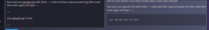

And for your Games if you have trouble open a new Topic please!!! Your driver looks correct installed.
Also post your garuda-inxi with three ~~~ enter and then copy and paste inxi after enter then enter again and type ~~~
your garuda-inxi in here
