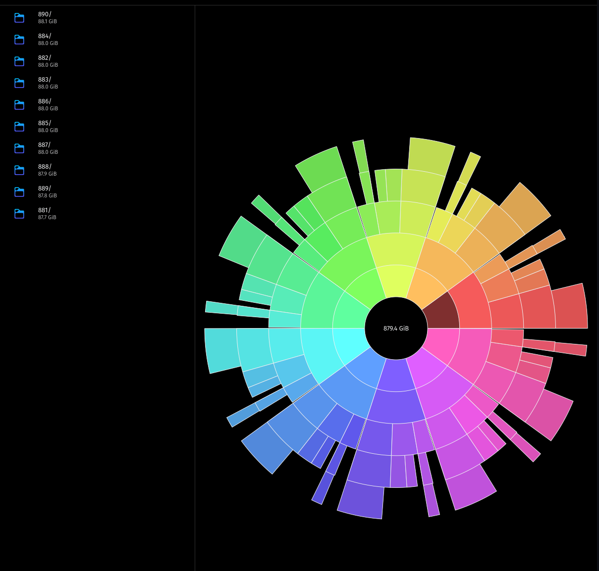

BTRFS Snapshots consume over 800 GiB?
Image attached. Not sure if it’s backing up more than it should or i I have too many snapshots or what. I don’t want to mess with it as I’m not sure what’s okay and what isn’t
My root drive is 2 TB, I do have other drives so I’m not in a rush (not running out of space soon) but this is nearing half the capacity of my main drive
Are they supposed to be 80 GiB each?

You can’t use a tool like that to see snapshot size. It will show you the full size of the snapshot, not how much disk space it is using.
Meaning your filesystem was using 80GB when you took the snapshot. Not that it is using that much now. Snapshots only contain references to data blocks and only take up extra space for any data that is not in any other snapshot/subvolume.
Thanks, looking into this further. It appears the “apparent” space taken up by snapshots is drastically incorrect
This is more a function of how the BTRFS filesystem works vs more “traditional” filesystems like ext4. Most storage usage utilities don’t do the btrfs calculation out of the box. For example, if you want a more accurate accounting of the actual usage “on disk” this command works well: btrfs fi us -T / (or this, which is the full command btrfs filesystem usage -T /). If you run it with sudo before you run the command, it will give you a complete, per-device usage as well.
