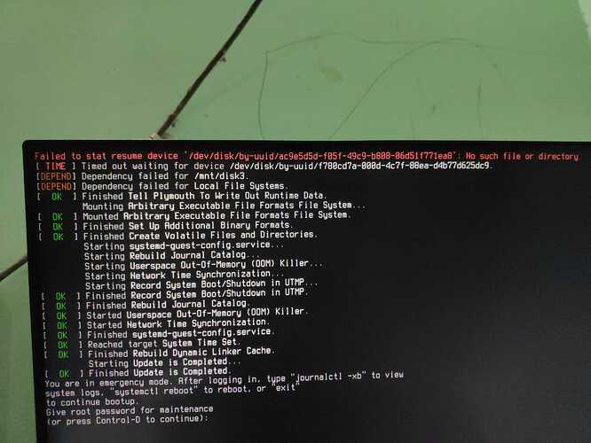

Now facing such error
I’m not sure how to proceed.

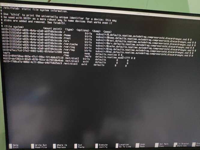

My fstab
  GNU nano 7.2                                                                   /etc/fstab
UUID=21552d5d-e026-4b4a-a2a8-ab97d6cbccde /              btrfs   subvol=/@,defaults,noatime,autodefrag,compress=zstd,discard=async,ssd 0 0
UUID=21552d5d-e026-4b4a-a2a8-ab97d6cbccde /home          btrfs   subvol=/@home,defaults,noatime,autodefrag,compress=zstd,discard=async,ssd 0 0
UUID=21552d5d-e026-4b4a-a2a8-ab97d6cbccde /root          btrfs   subvol=/@root,defaults,noatime,autodefrag,compress=zstd,discard=async,ssd 0 0
UUID=21552d5d-e026-4b4a-a2a8-ab97d6cbccde /srv           btrfs   subvol=/@srv,defaults,noatime,autodefrag,compress=zstd,discard=async,ssd 0 0
UUID=21552d5d-e026-4b4a-a2a8-ab97d6cbccde /var/cache     btrfs   subvol=/@cache,defaults,noatime,autodefrag,compress=zstd,discard=async,ssd 0 0
UUID=21552d5d-e026-4b4a-a2a8-ab97d6cbccde /var/log       btrfs   subvol=/@log,defaults,noatime,autodefrag,compress=zstd,discard=async,ssd 0 0
UUID=21552d5d-e026-4b4a-a2a8-ab97d6cbccde /var/tmp       btrfs   subvol=/@tmp,defaults,noatime,autodefrag,compress=zstd,discard=async,ssd 0 0
UUID=e7acc7cd-2fe2-4482-b401-85fb5ef12388 swap           swap    defaults,noatime 0 0
#UUID=ac9e5d5d-f05f-49c9-b808-06df1f771ae8 swap          swap    defaults,noatime 0 0
tmpfs                                     /tmp           tmpfs   defaults,noatime,mode=1777 0 0
#UUID=094f50aa-865e-47cf-99bc-9f14b0c67118 /mnt/disk2   btrfs    defaults        0       0
#UUID=def202c3-02a9-4570-951e-dcf9210b46ab /mnt/disk3   ext4     defaults        0       0
UUID=f780cd7a-000d-4c7f-88ea-d4b77d625dc9 /mnt/disk3   ext4     defaults        0       0
