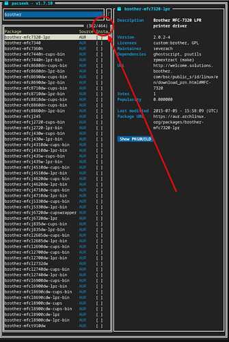

pacseek brother
There are 464 hits for “brother”. A handful are not related to printers, but almost all of them are printer drivers for a specific model of Brother printer that have already been packaged and are ready to build. All you need to do is identify the model of printer you have and install them manually with makepkg, or with an AUR helper like Paru.
