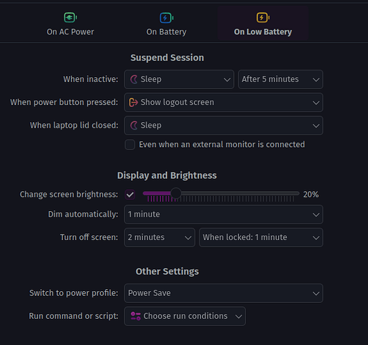

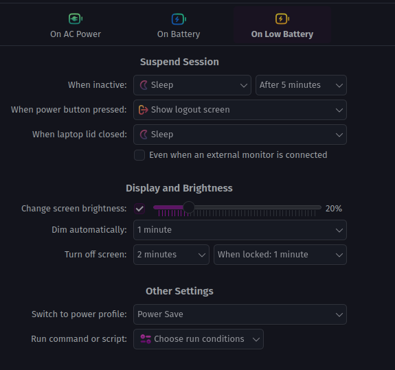

updated and booted into X11 and it’s still blindingly bright. After the update it did show a meter for brightness in the power settings but whether I use the keyboard or the settings it still won’t go down ):

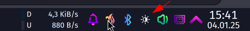

I use the icon in the tray bar. But Fn 5+6 works too.
it doesn’t seem to be having any affect on it and even with warm mode it’s very bright and blinding ): Perhaps a few updates down the line it will switch but maybe I should have turned down the brightness before installing Garuda o-o I was able to get the control from the panel but goodness gracious o-o
I have to keep the warm settings on because of how bright it is … xD

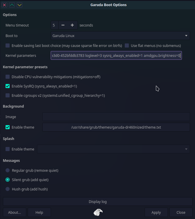

If switching to the LTS kernel doesn’t help, try this kernel parameter: amdgpu.brightness=0
Just open the Garuda Boot Options and add it under “Kernel parameters”, like this:
Apply → Close and reboot the system.

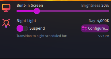

thanks so much for the patience of everyone here with this new blood Linux user who’s only been on Garuda for about a month and a half. I was finally able to hash out the problem in the BIOS by switching from the hybrid setting to the discreet setting for graphics. I now have my brightness at a comfortable 20% and it doesn’t hurt my eyes and give me a headache to use my computer now :smiley: Thanks again everyone :slight_smile: !!
