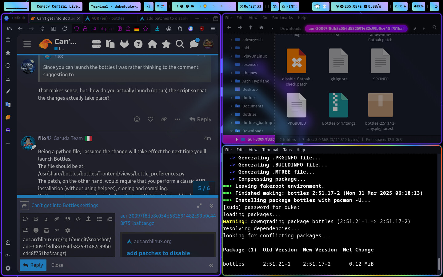

i am facing also problems with Bottles too. Did you try the patch to downgrade it again?
I am actually on the Kernel 6.12.21-1-lts and patched it yesterday for testing and it worked see in this Post here
thank you… I will look into it… that’s a tarball… it should be fine for xfce I would think… but I appreciate the help
I did test this on xfce and hyprland =) we dont know which system you are using because the missing garuda-inxi output from your terminal :wink:
I’m not seeing a make file… or a readme… at the risk of sounding like a noob… which script am I running… I’m not sure what I’m looking at here
if you use the aur bottles it dosnt work well with the buttons. i got errors in the terminal if i clicked on the buttons. These is a patch file and pkgbuild in the .tar.gz Folder where you can make in the terminal. It will downgrade the newer version to an older. @Filo posted a newer aur websites patch file but i didnt tested it yet but im in the mood to do now beside test the newer patch on my xfce.
ps. it will disable the flatpack check because its not installed over fatpacks , you can install the fatpack version if you want but like i read in the forums fatpacks are not recommended =)
ps. i removed my downpatched file and reboot installed the normal bottles same error.Patched with the newer file didnt work. Patched with the older file back down to the 2.51.17 -2 and it worked again =)
After that post, Bottles was updated to 2:51.21-2 including that patch.

Wired :wink: yes thats right but i did test on my xfce machine and didnt work. Only if i downgraded it.
Honestly, I only did some testing during the discussion in the other thread, because I am planning to replace a Windows application (but not very important).
In the end I realized that for Bottles the flatpak release was the best thing. It worked perfectly for me.
I don’t usually use flatpaks, but if I were to decide to use Bottles I would use the flatpak one.
Yes i agree with you because i did now install Bottles on my Kde Version and it is just crazy. The new update broke it on my Hyprland and also didnt work yet on Kde. I cant create a new Bottle now on both Hypr and Kde before Hypr was fine.
