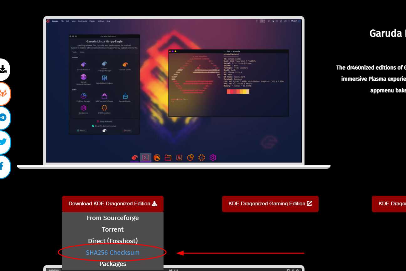

Did you check sha256sum?
Oops , red mark is wrong.

ı don’t know about sha256sum.

This should be done when you download an ISO to confirm it downloaded intact–sometimes it does not (packet loss, or otherwise).
