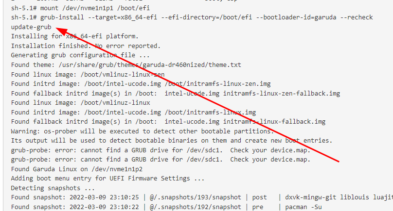

One thing I did spot is in one of the pastebin outputs above (the one where grub is successfully installed), update-grub is added to the end of the grub-install command.

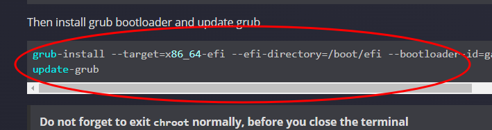

I’m guessing the whole chunk was copied out of this command box as one piece:
This should be two commands. So:
grub-install --target=x86_64-efi --efi-directory=/boot/efi --bootloader-id=garuda --recheck
After that command finishes, then run as a separate command:
update-grub
The way it was run together, I do not think it took the update-grub and so the grub configs weren’t correctly modified.
That fixed the issue thanks everyone for the support you guys have been incredibly helpful. @BluishHumility no worries it didn't cause any issues.
