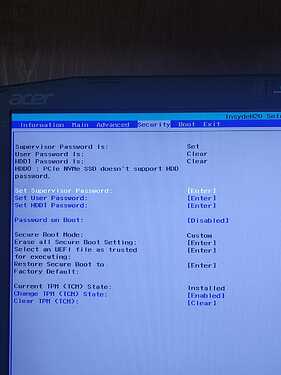

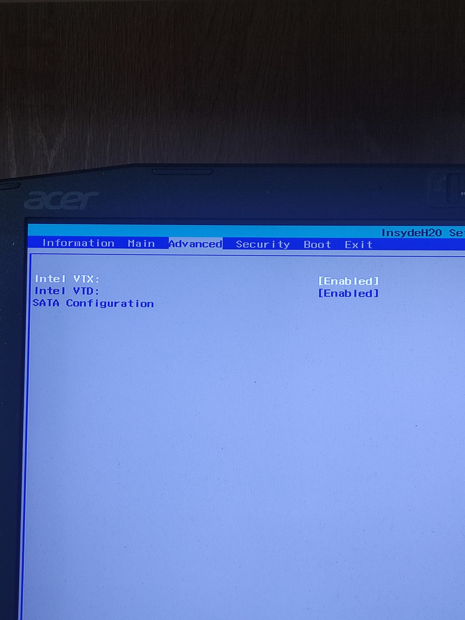

Garuda (2.6.19-2):
System install date: 2023-11-25
Last full system update: 2023-11-25
I recently installed Garuda on an Acer Predator Laptop: I5 8300h, 16 RAM, GTX 1060 and everything works fine except that every time I close the lid of the laptop the fans never stop completely and when I open it back up the screen is black with just the mouse which is frozen.
