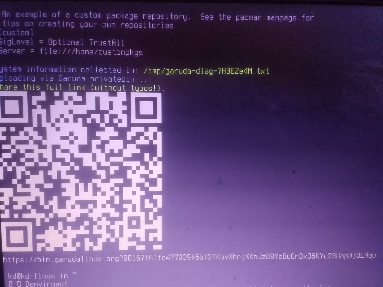

ITS STARTS AFTER REBOOTING MY LINUX AND TESTING THEMES OF LOGIN SCREEN AND I GET BLACK SCREEN AND MOUSE IS FULLY FUNTIONAL BACKGROUND IS GONE WHEN I BOOT NO LOGIN SCREEN ONLY BLACK SCREEN WHERE I CANT LOGIN I NOT TRIED TO LOADING A SNAPSHOT AND ALSO I INSTALL FLAT HUB BEFORE TESTING THE THEME AND FIRST THAT PHOTO I HAVE BEEN UPLOADED ITS COMED AFTER RUNNING THIS VMD garuda-diag AND I GOT THAT LINK THAT THE PHOTO HAVE IN DOWN YOU CAN SEE AND IM GOING TO UPLOAD 1 MORE PHOTO WHICH YOU SAID TO RUN THIS CMD garuda-inxi AND garuda-inxi | garuda-privatebin AFTER RUN THIS COMMAND I WILL UPLOAD PHOTO SRY FOR NO PERFACT ANS I GOT CONFUSED IF WANT MORE THING THEN SAY PLS DONT MOVE THIS TOPIC TO 4xx client error IM NEW AT GARUDA LINUX SRY…

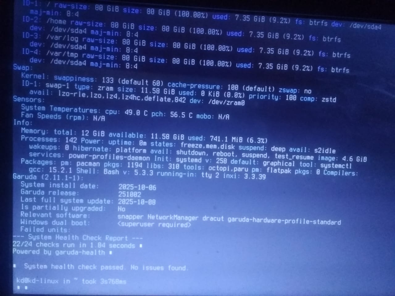

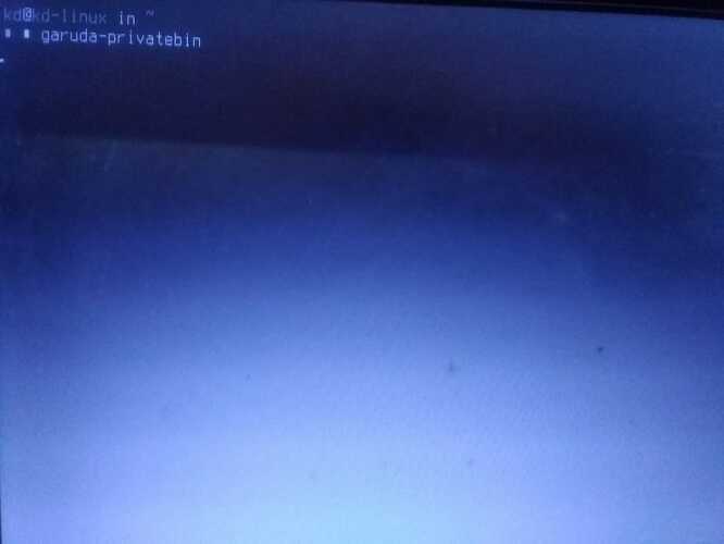

ahh what you sayed pls say again and here is run this cmd pic i cant copy becouse im righting from windows so picture (garuda-privatebin)
i dont get any out after waiting 2 miniute +
(garuda-inxi)
SRY FOR LOW QUALITY PICTURE

its starts after rebooting my linux and testing themes of login screen and i get black screen and mouse is fully functional background is gone when i boot no login screen only black screen where i cant login i not tried to loading a snapshot and also i install flat hub before testing the theme and first that photo i have been uploaded its comed after running this vmd garuda-diag and i got that link that the photo have in down you can see and im going to upload 1 more photo which you said to run this cmd garuda-inxi and garuda-inxi | garuda-privatebin after run this command i will upload photo sry for no perfact ans i got confused if want more thing then say pls dont move this topic to 4xx client error im new at garuda linux sry…
Please, no pictures from terminal.
Images can be read worse, are not searchable and copyable for further search.
So, I just add your garuda-inxi as text to your picture.
Where was the problem for you to copy and paste it from your QR-Code or https link?

I haven’t looked at your garuda-diag yet, as I don’t have the time or inclination to type those endless link from the pic into the browser. Ah, I see @SGS was so kind. :slight_smile:
Next time, just pipe it to termbin, like this:
garuda-inxi | tb
The links generated this way are only a few characters long and are better suited for a tty if you don’t have a suitable way to scan QR codes and/or post long links. “My” mistake. :wink:
