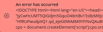

The bitwarden client apps are displaying error because of the cloudflare. This has made the service unusable. The web app is working fine after going through the cloudflare screen.
I was using this url: https://vault.garudalinux.org but when I switched to https://bitwarden.garudalinux.org it started working fine. Thank you

Interesting, i was using all the time (set it up as alternative subdomain after the bitwarden subdomain due to it being used more often as you said). Where exactly does this error occur in the client and what does it say (you just sent an incomplete picture?)
My account was automatically logged out and this was displayed when logging back in. I could not get the full message, the ui only displays that much.
I think this could be because the cloudflare is enabled on ‘vault’ subdomain and returns an html page displaying the captcha for the api request. But when I visited the ‘bitwarden’ subdomain there was no cloudflare redirect, so I think it is not enabled on this domain.
That’s also my assumption currently. I’ll try to debug it myself at given time, thank you.
