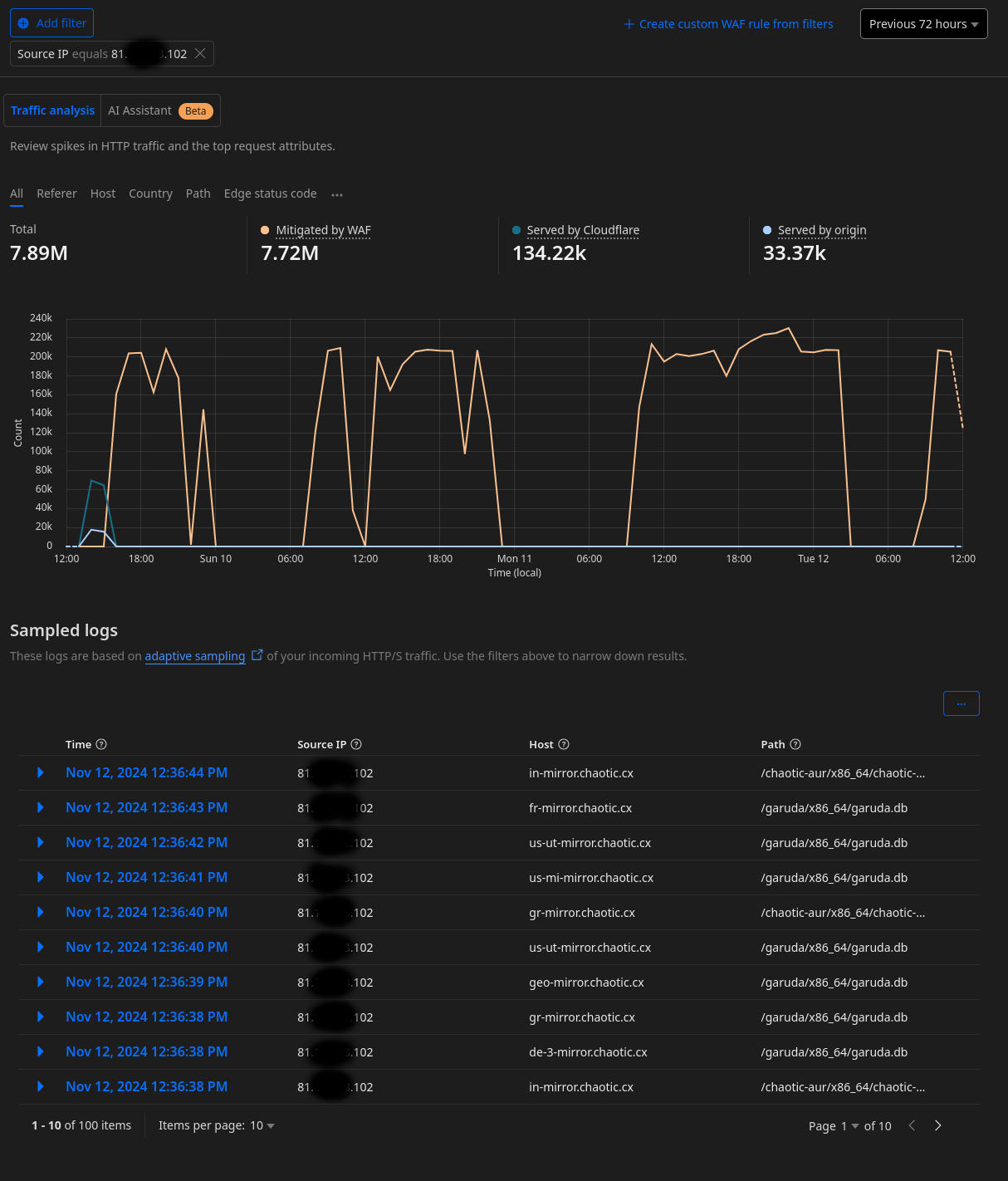

The thing is, since Sunday, we are getting an absurd number of requests from your IP. Valid HTTP requests, but at an absurd rate. This is all from your IP:
Oh my
Yes, that’s right and that explains it . I read that and forgot to mention it here :face_in_clouds: Those attackers really need to bugger off. :sunglasses:
Any clue why almost 8 million requests in 72 hrs? If we only count the active hours, that’s more than 3700 per minute. Is that from a fresh installed Garuda with no changes made?
I’ve stopped the script that’s checking for updates, I’ll avoid doing that so frequently! really sorry about that
That’s insane, I could have misinterpreted how much time the poll rate is but that’s a really high number
It shouldn’t be very effective, but it seems like your ISP has an ASN direct to the CF node that is the closest to our Heroku node, and we had WAF off. I’ll be turning the block off.
