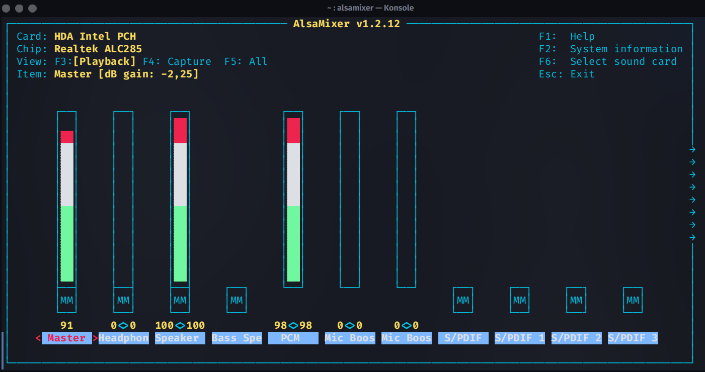

although I doubt this very much since you have reinstalled your system check out
alsamixer
and ensure none of the volume settings are mute (The MM will be highlighted when not mute)
also try select sound card using f6 in the same utility maybe you are just using the wrong sound card?

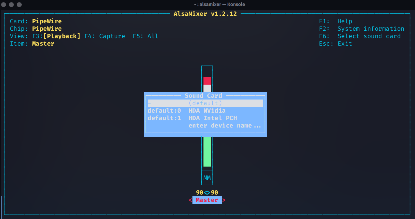

Yes I have checked nothing was muted as well. But after you wrote I tried again and figured out that when I exit alsamixer, whenever I try to change volume level it gets muted. That could be a clue.
Also ,there are different options when I press f6 on alsamixer, on default option it says pipewire for both chip and card. When f6 I have options and I’m choosing the Intel one.

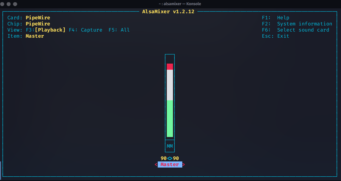

And everytime I enter alsamixer, I see the first picture (pipewire as the device)
Am I doing everything right?
What I learnt from you, I was thinking the muted-unmuted part opposite way. So I make all the MM’s green now. May be I can focus trying other solutions again while everything is green.
