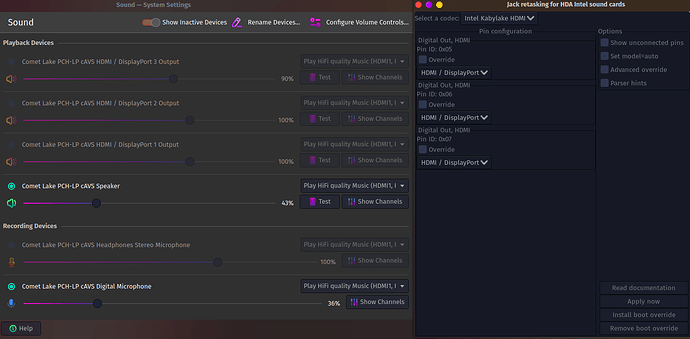

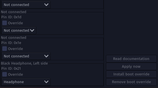

Did some digging around on my audio situation and came across HDAjackretask. My results with it seem to be a little funky though. Though I’m not 100% sure how to configure it. For some reason my default set up is the HDMI stuff which I took a screenshot this time around for better context.
When I open the retasker the codec on default is “Intel Kabylake HDMI” which likely explains the “comet Lake PCH-LP cAVS speaker” and the other 3 “HDMI display ports”. Which … those only work if I plug it into a TV using an HDMI cord which is why I generally have the Comet Lake selected and can’t select any of the inactive ones.

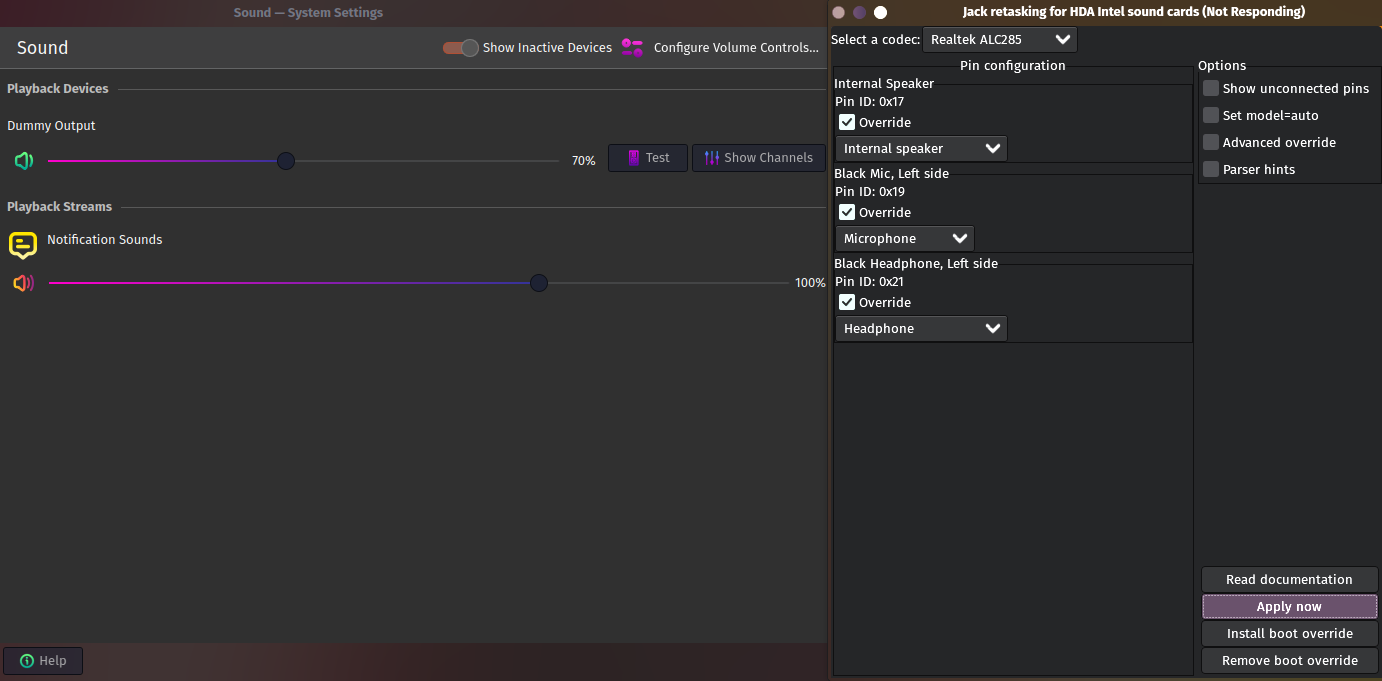

But check out what happens when I try to change to the other codec which is “Realtek ALC285”
The program becomes unresponsive, then I end up with no audio or the “dummy output” which generally means I have no audio. At that point since retask is unresponsive I have to then kill it. Though thankfully I atleast know enough not to select “install boot override” instead of just “apply now” because restarting does put my audio back on the default.

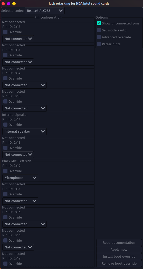

I guess this audio situation is a pretty common problem but no one seems to know much on how to fix it ): I have heard of others getting success with the retasker but my guess is that it has to be configured in a very specific way. When I click to “show unconnected pins” I get this result
Atleast I have normal audio when I plug into a TV though … xD But that’s probably because it takes from the audio inside the TV at that point

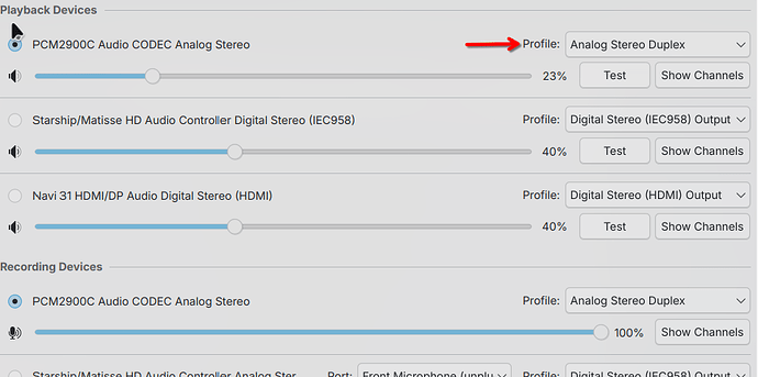

I can’t answer on the app as I haven’t seen it used in many moons. But your first picture there, what are your options in the profile area.
I have “play HiFi quality music(HDMI 1, HDMI 2, HDMI 3, mic1, mic2, speaker)”, “Pro Audio”(which completely mutes everything), and “Off” which absolutely nobody wants XD Thank you for your time otherwise. Currently I don’t have JamesDSP or easyeffects because while they do well in the area of tweaking and amplifying, one could only amplify so much before the sound starts clipping and sounding too “bassy” I guess would be what to call that.

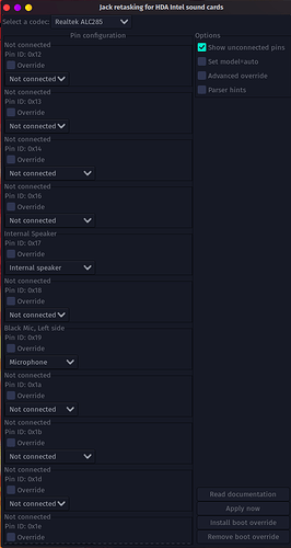

edits: I found a thing online about the retasker and tried that configuration and it still crashed o-o
install: alsa-tools (I chose ‘echomixer’ in pamac)
run in terminal: hdajackretask
select code: realtek alc285
options: show unconnected pins
override:5.1. 0x14 → Internal Speaker (Back)5.2. 0x1e → Internal Speaker (LFE)
click: install boot override
reboot
I didn’t do boot over ride for safety reasons at this point, but clicked apply with that setting while I had music playing and right when it password prompted me. The audio configuration went back to “dummy audio” and then I didn’t have sound again. I did cancel it and my sound came back but when I tried again with the same configuration my sound died and because the program becomes unresponsive, I have to force a restart because it won’t close correctly. When I got the screenshot of the program crashing dolphin also crashed so that wasn’t fun. My audio is clearly cooked no matter what I do ):
