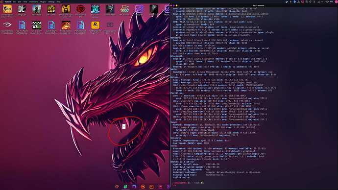

I have a problem when I open Steam (installed using wine)
Once the program opens, an annoying little white box starts with the program and is overlayed on top of everything, including running games, despite the in-game video settings.
I tried installing Steam multiple different ways and each time this problem persists.
Is there any solution, or at least a work-around to getting this to go away or at least display below everything else?
It is a white rectangular box about 4 times larger than my mouse pointer, with a black " | " in the middle of it (tried uploading a screenshot but I'm a new user here).
Thank you.

I noticed both of those versions only allow me to play steam games that are compatible for Linux so I downloaded the windows version of steam and installed using wine and the games run perfectly, better then they did on windows but there is that small box that overlays on top. I confirmed that the same thing is happening on my wife's laptop that's running Manjaro. Same box. You guys are saying I should be able to play windows games from those two paru clients? Do I have to enable some kind of compatibility or something like that?

Hi there @0baak
I increased your trust level to TL1 from TL0. Please post the screenshot, so that we can see what is the actual issue.
Without Text?
So we need no picture.
Or post the text as text, please :slight_smile:

Was able to resolve the issue
Problem resolved:
I used winecfg and added steam.exe in, and in graphic tab enabled "emulate a virtual desktop" and the white box went away.
