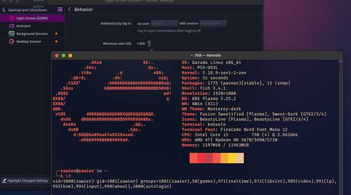

Autologin is getting assigned GID 1000.
Try removing the autologin option on Calamares, then set it up in KDE settings after your installation is already up.

The reason you couldn’t change the gid was because the number was already in use. I sidestepped that issue in my previous example by uninstalling the package that had appropriated the 1000 gid. In your case you would likely want to disable auto login if it is using 1000. You can re-enable auto login later and it will be given a higher gid.
You need to change the group ID that is currently 1000 to a higher number, then change your user’s gid to 1000 as in the example below:
@petsam may be correct in that having both the uid & gid identical may not be entirely essential. However, that is the way I always configure my system, and that is the way most installers configure a new system by default. I always setup all my systems with an account with the same username, uid and gid. This avoids access issues on drives formatted with a Linux file system that restricts the access permissions.
I assume it was setting up your system with auto login at install time that changed the default GID. I have experienced this on some distros, so I will only enable auto login after installation to avoid this. The standard gid & uid on most installs is usually 1000 for the first user account setup on the system.

I will try to leave those ids as they are , install Timeshift and Docker and try update a system a few times. On current set up I had done it 3 times already and it didn’t break so far. What I suspect is fact than one time instead of garuda-updateI forced pacman -Syu and maybe that command was guilty of current situation. Newest snapshots which were restored also inherited that change. So it’s my best guess why my case is unique right now.
