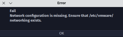

It gives me this message:
Re-installing from Octopi can’t fix the error, and give me this error. My VM’s are without network and I always have it.
Updating module dependencies...
==> ERROR: Missing 6.5.3-arch1-1 kernel modules tree for module vmware-workstation/17.0.2_21581411.

Try the suggestion from this thread: Network configuration is missing. Ensure that /etc/vmware/networking exists. - r/vmware, and this thread also: [SOLVED] VMware guest host - No connection / AUR Issues, Discussion & PKGBUILD Requests / Arch Linux Forums
systemctl start vmware-networks.service
If that doesn’t help, try the suggestion here: https://wiki.archlinux.org/title/VMware#Networking_on_Guests_not_available_after_system_restart
Networking on Guests not available after system restart
This is likely due to the vmnet module not being loaded [4]
It links to this thread here: https://www.linuxquestions.org/questions/slackware-14/could-not-connect-ethernet0-to-virtual-network-dev-vmnet8-796095/, with a suggestion to try to modprobe the vmnet module:
sudo modprobe vmnet
After try this:
Didn’t work.
After try this:
sudo modprobe vmnet
Works until next reboot.

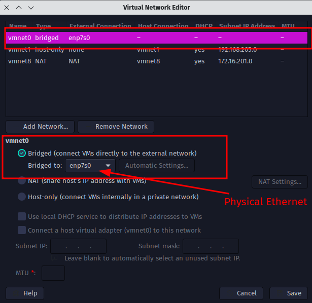

So, I re-installed vmware-workstation, reboot. Reconfigure the vmware “Virtual Network Editor”, with this:
… and now VM’s network are functional.
I will see if after shutdown or rebooting or updating, this configuration changes or stop working.
OK, I have returned to normality with:
modprobe -a vmw_vmci vmmon
… and the activation for every boot of the vmware network service.
systemctl enable vmware-networks
That works for me.
